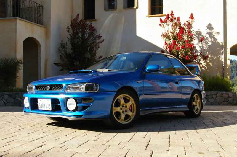

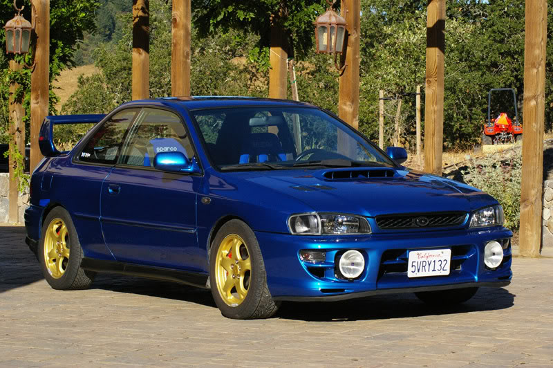

Final Build Update:
the car is actually running well right now, im getting it alligned and balance tomorrow
its running well, but rubbing on the coilover sleeve on one side, so i need to get that worked out and then it should be all good

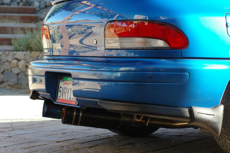

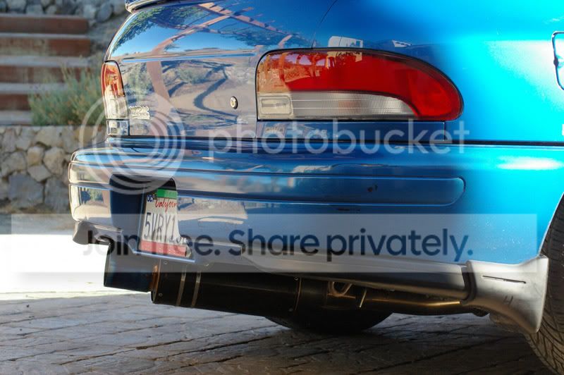

btw the exhaust pipe turned completely blue for some reason, not sure why. still looks cool though
Stainless steel does that when it gets hot. it was gonna happen no matter what. i had a stainless still tip on an old car and it did it there too. its normal dont trip.

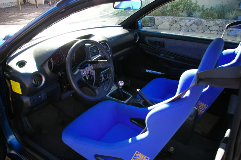

I saw your post over in the Pimp GC8 thread on NASIOC, which surprised me because I thought you were still hunting for you immobilizer issues. Not to many updates lately huh? I'm glad to see the car is on the road. Nice Choice on the seats, full buckets/non-reclining FTW. That could be a serious machine, but the next thing you need to do is get some Dunlop Star Specs. Tires are the key!

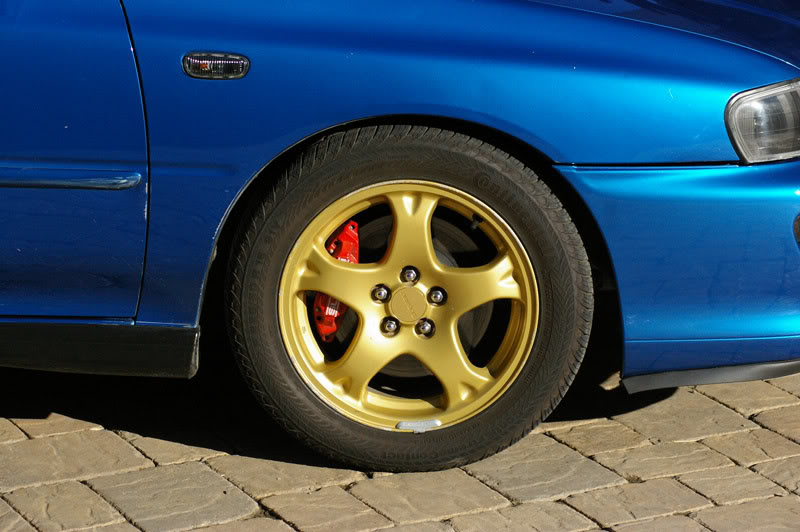

also, the tire on the passenger rear was rubbing on the coilover because the camber in the rear was -2.8 driver's side and -3.something on the passenger side and it the camber is not adjustable in the rear, so i ordered some H&R camber bolts which should be coming wednesday from JSC Speed
