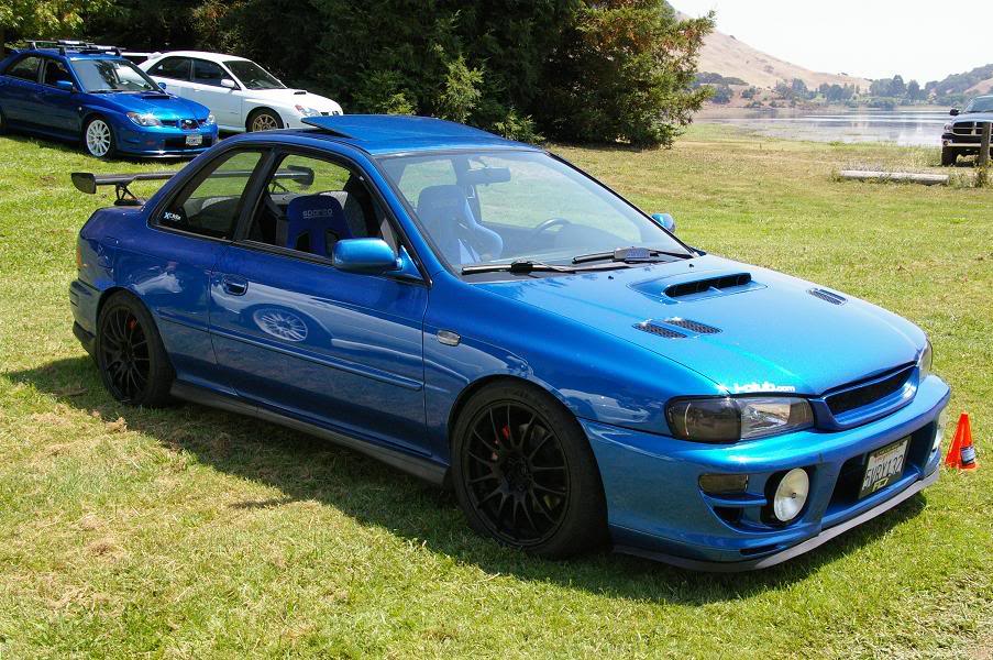

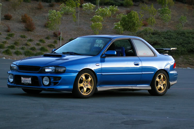

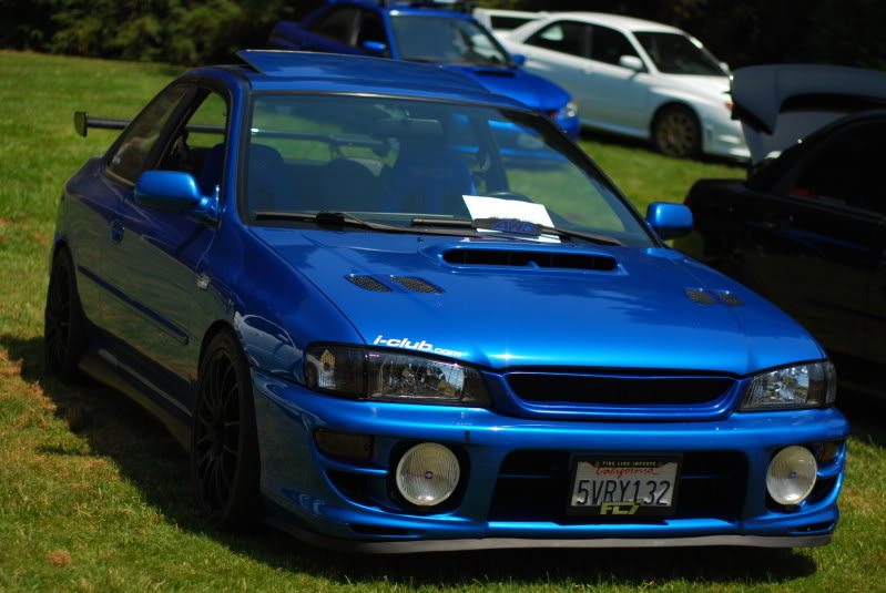

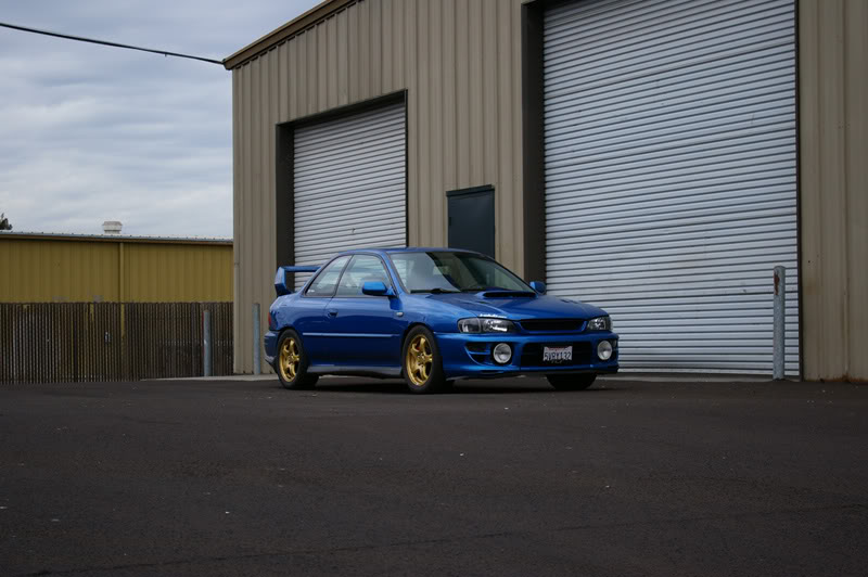

long time bump here - not a whole lot going on.
Coilovers finally gave, rears are blown, whole set needs rebuild. Going to buy some lowering springs in the meantime after I sell these.

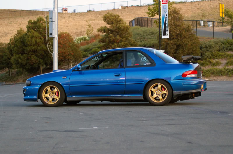

Been to Thunderhill raceway twice, car handled wonderfully. I need to get it off to an allignment shop to straighten some stuff out, but for the most part, it kicked ***.
I need to upgrade the brakes for the track, Hawk HPS and stock rotors are no good, lots of fade - can you say smoking brakes lol? - soon to come, slotted rotors, Hawk Track pads, SS brake lines.
I bought a 2003 OBS that I'll be fixing and selling to make good profit, once thats done, I can get myself some coilovers and better brakes, potentially fix the rust - maybe.
For now, here are some pictures to hold you guys over

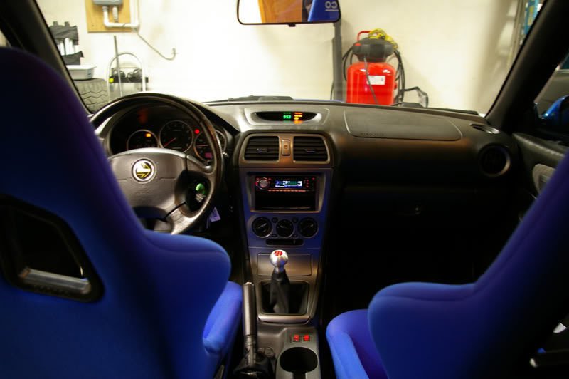

Hey one quick question since ya got a 06 swap(working on it right now)
Did ya keep the old heater core? and how hard do ya have to tug after removing the 3 bolts that bolt it to the firewall

I kept my original core (it's all I had) and there's really no reason to put a different one in.
Be sure to detach the coolant input and output lines from the engine bay, and remove all the mounting bolts from the AC/fan housing.
It's a major beeeyotch to coax out, as there are plastic alignment pins that mate to the AC/fan housing. If you are catching resistance stop, as it yanking on it may break some important stuff.
Also, the recirc/lower air manifold on top of the transmission tunnel will catch the core; it's light gauge ABS so don't worry about crushing it.
I have removed/replaced my core over 5 times since I was troubleshooting my wiring on the weekends and using the car a a daily driver during the week.

I removed the old heater core, I can't remember it being difficult at all.
I did replace mine with the new o6, which was a pain for sure, but only because I have GD dash in my car, otherwise there would be no point to replace it. I almost wish I kept the RS dash just to make things easy, but it definitely looks really nice with that new dash in there

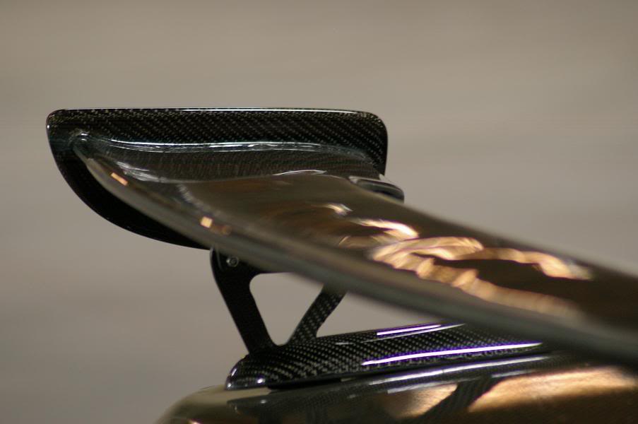

also, sold the V6 wing, got the CF trunk clear coated at maaco. Some orangepeel, but it is only noticeable close up. s202 wing is on. Car needs a Cwest lip which will go on soon here, probably before anything else.

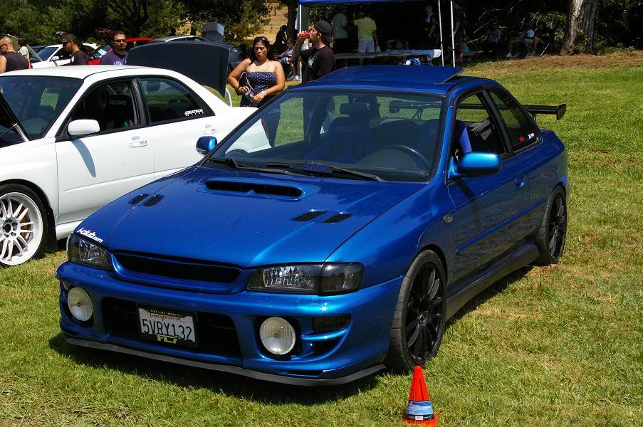

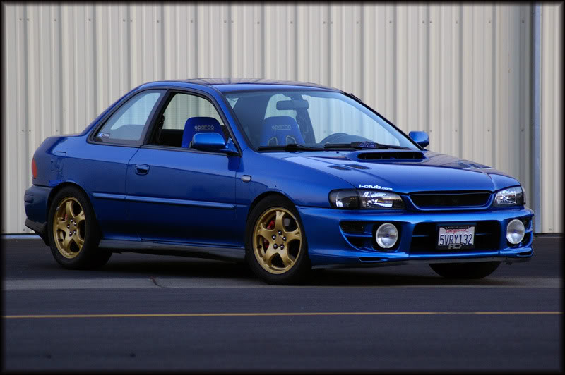

some pictures
