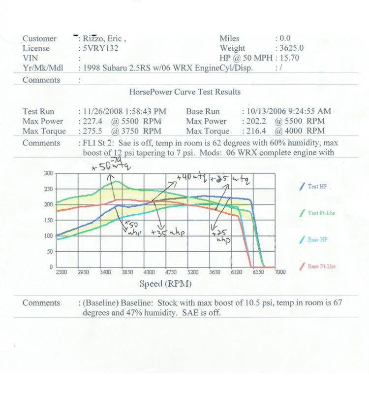

yea, the guy at fine line said that it would be a good idea to go with a bit lower boost than a normal stage 2 because i don't have a bellmouth downpipe, so there would be more back pressure which could damage the turbo. Plus, its a fairly mild tune, but it still made some nice power.
here is the dyno sheet from fine line imports

given any thought to having someone else look at the tune?
Stock boost is more than that.

hm, well not really actually, its kind of a mild tune. if i go back though for more psi or something, it would cost me quite a bit, more than im willing to spend right now :/ .
what is stock boost? isnt it something like 10-11 psi?

Even an STi runs like 14.5psi stock iirc. I'd imagine wrx's run less. I don't see how there's anything wrong with his tune. Also considering the fact that he's on a tight budget apparently, it's not as if Rizzo is slapping on every free flowing upgrade onto the exhaust side of the turbo which would enable him to make more power and run more boost. He even mentioned it was a conservative tune. I'm sure if he said "I want to make as much power as possible with this setup, don't be conservative", then he'd have gotten a map with more boost than stock. I don't see what it has to do with the tune...

but yea the tune is all good, compared to stock, this thing pulls like a mother****er, i really love it a lot. eventually i'll step it up and go for the sti turbo upgrade, but for now, this will be just fine.

12lbs out of the TD04 sounds pretty good. Conservative enough to prevent any premature failure. Peak HP means nothing w/o reliability. Those torque #s are great and thats what you need to put the power down. Im sure you can wring more out of the 255 with a VF39, Pink injectors and a Walbro. After all that work, just sit back and enjoy while gas is still cheap!

hmmm that seems like low boost for a stage II protune...
My 07 WRX was hitting about 16.5psi Cobb Stage II I think. My 08 STi Stage II hits 19psi

thats the plan, go with the VF39. Soon probably too, I've got a mini business plan that seems to be working out well for me; buy cars that need some help and sell them off. I did one and got $1400 in profit and now I'm working on a '95 525i that needs a headgasket, this one should give me about $2500 or more dollars in profit when done
The tune is a bit conservative, but since the torque numbers are pretty high, more than a stock sti. The thing seriously hauls *** off the line, I'm really happy with it. PLus, the car is pretty light too, I haven't weighed it, but it should be somewhere around 2800lbs Definietely a huge improvement over stock with just a pipe really.
