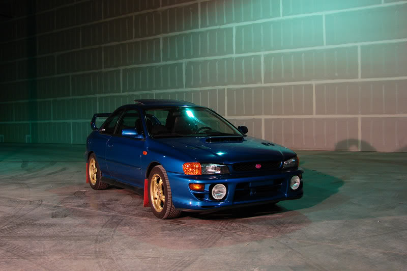

My car in all its glory (now sans mudflaps, and will be unless i attend a rallyx)

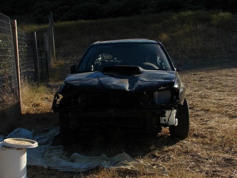

what i had to start with

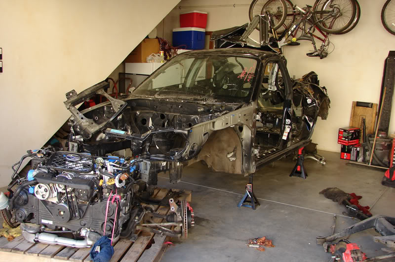

what it looked like 2 weeks ago

now to my car, as of tonight
partially stripped interior
roar wheelie
yay
final shot for today
that will be it for today, ill update as i do more work (probably this weekend). If you have any questions let me know.
