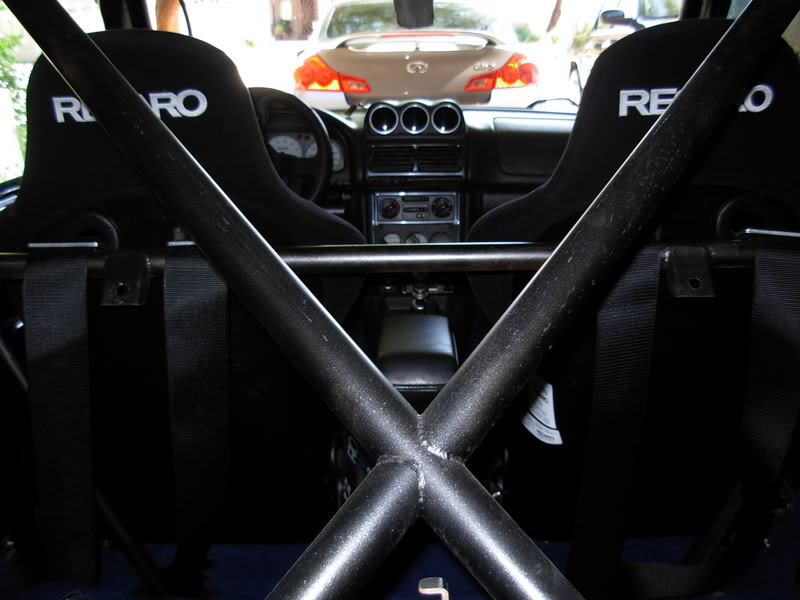

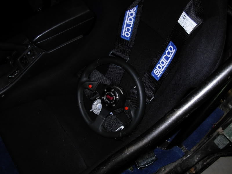

Kinda hot to get much done today, going to wake up at the crack of dawn and get more done. Still waiting for battery, but we installed to seats and harnesses, they feel awesome. new gas pedal and cable should be here thursday. need to pick up some race gas, but should be running by this weekend. then to the body shop for roof & paint!

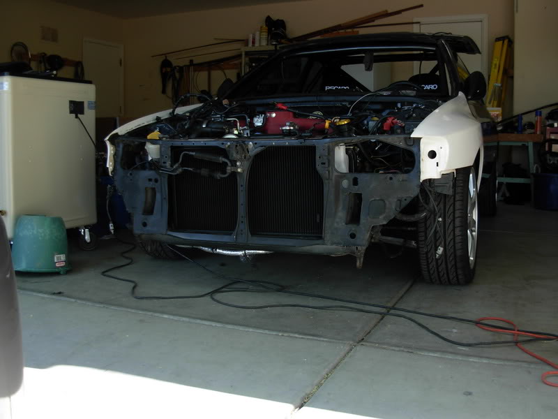

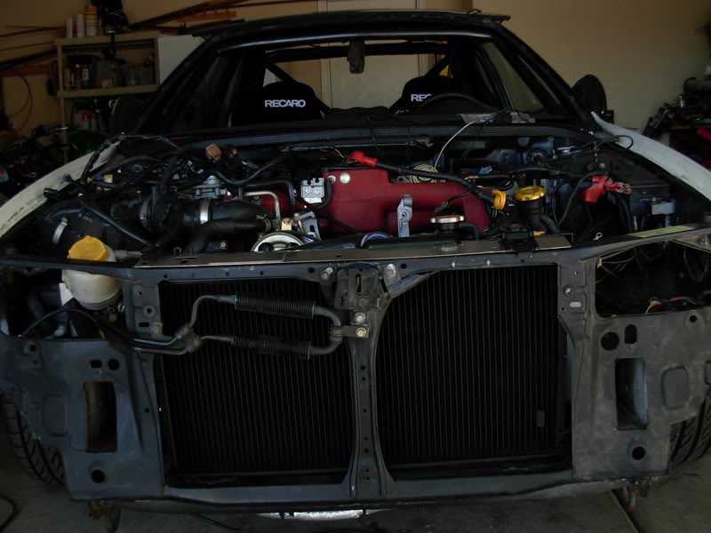

Here's how she's sitting now, going to get back to work on it later today after it cools down a bit.
