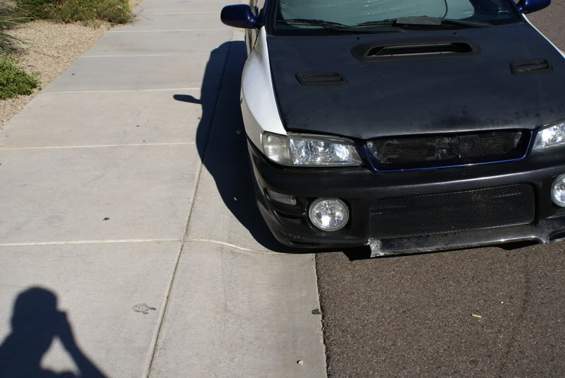

Here's "new" chassis, 1998 2.5RS coupe
When I first bought it

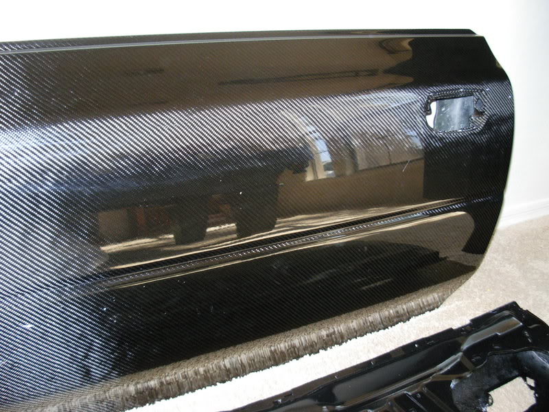

Seibon CF doors

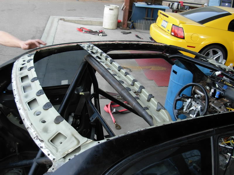

Roof replaced with L roof skin (sunroof delete)

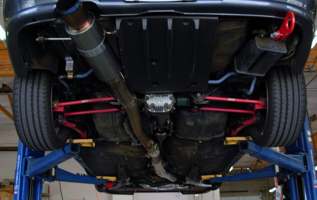

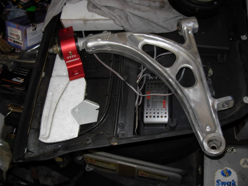

GC8 Pink STI Full pillow ball lateral links
GC8 Pink STI trailing arms
JDM GC8 Aluminum front control arms
Perrin (PSRS) anitlift/castor kit

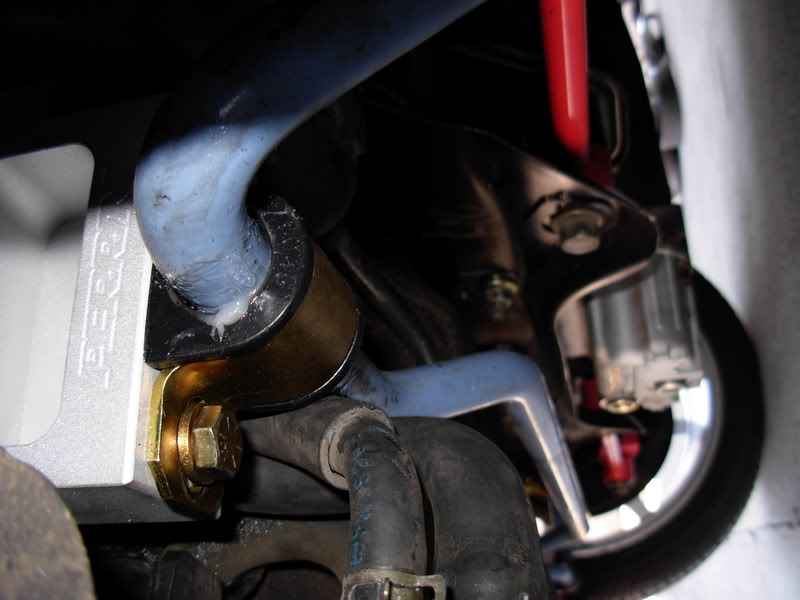

STI front swaybar
Kartboy Front Swaybar Endlinks
Whiteline 22mm rear sway bar
Perrin Heavy Duty rear swaybar mounts

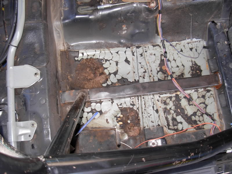

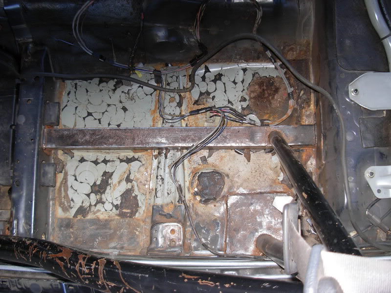

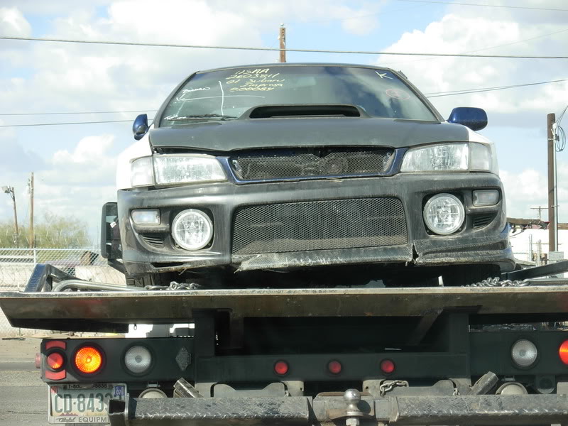

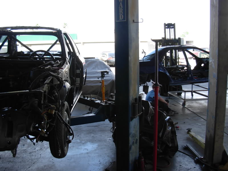

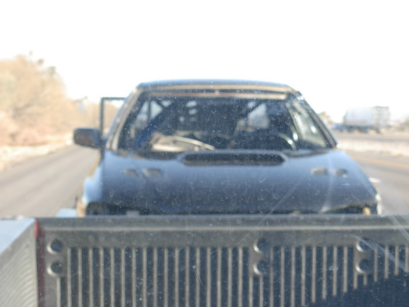

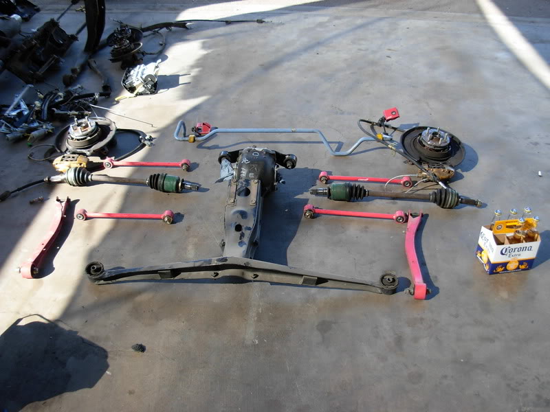

Here's what I had to start with, it used to be a 10-sec drag car, but it had been sitting at a friends shop for some time before he sold it to another shop owner in tucson. I bought it from that owner, and started cleaning it out, it was quite a mess!

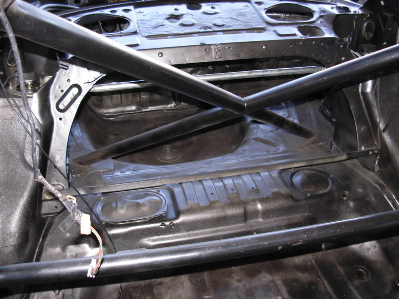

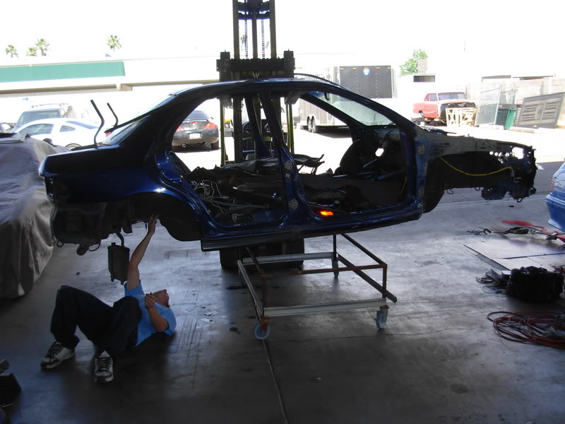

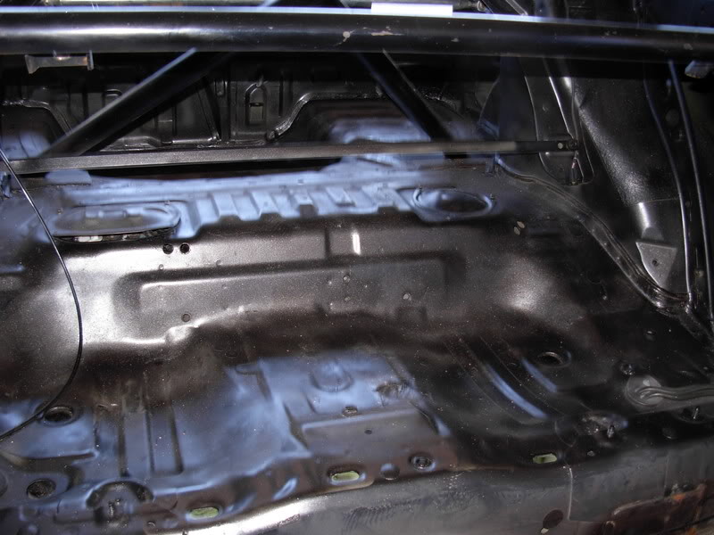

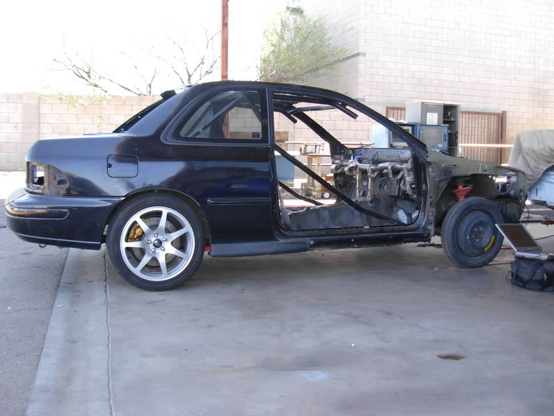

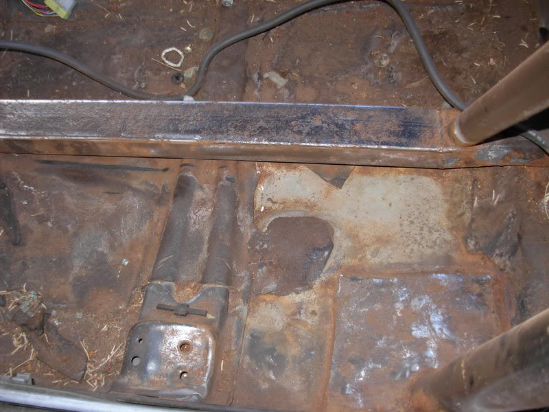

Removed rust, trim panels, sunroof, roof skin, and all the other junk that wasn't needed.
Sanded and repainted interior (prior to entire cage completion)

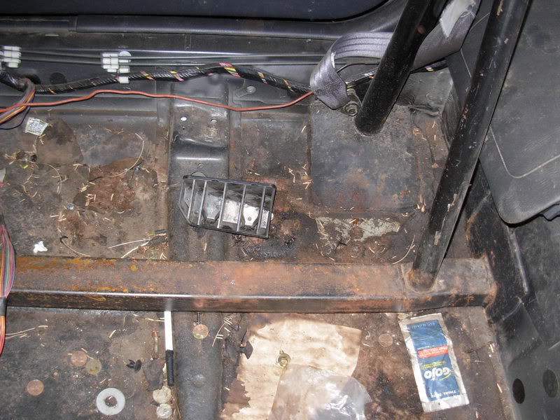

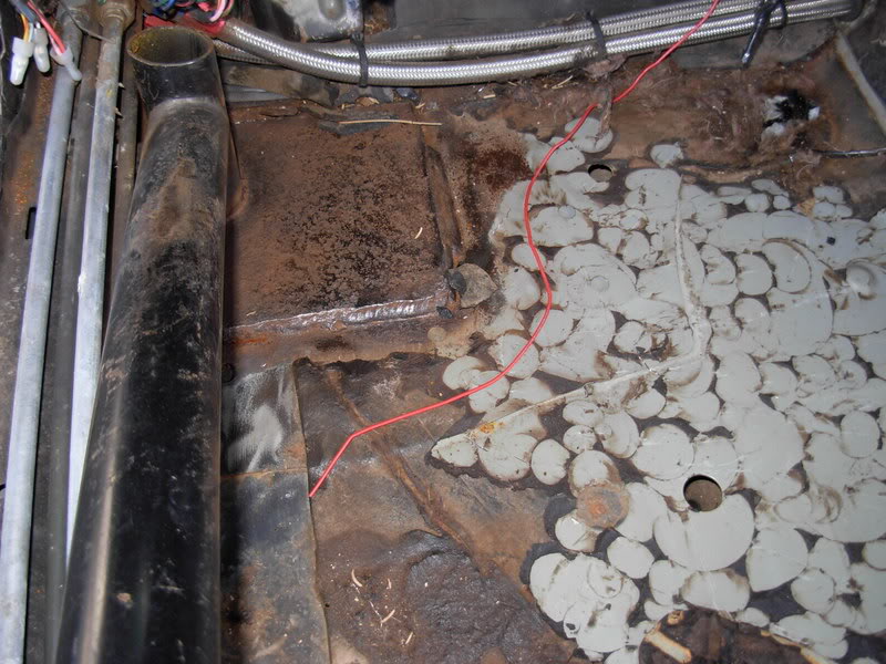

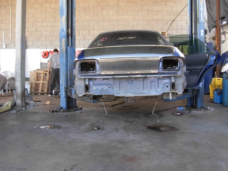

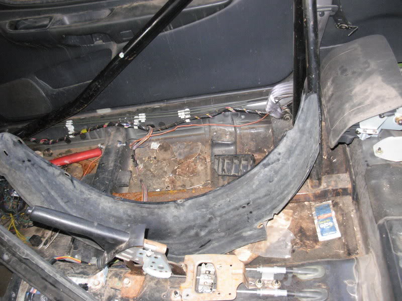

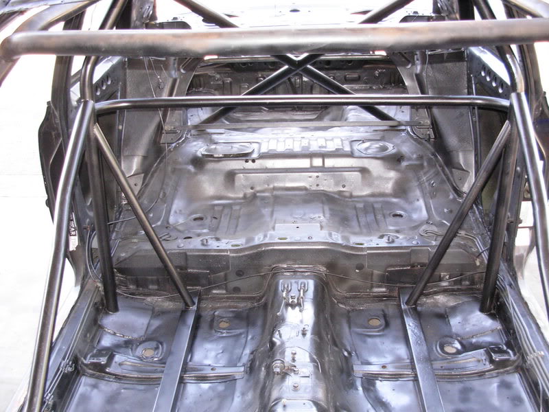

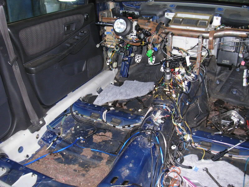

I spent a few hours a day for a couple of weeks, didn't really keep track of the time. I'm working at my Friend's shop and he has an 4 wheel Dyno, so I can take breaks, cool down, have a beer and watch some crazy vehicles on the dyno. Here's my Daily Driver, 2007 G35S 6-MT
/\ See the Old subi caracass in the back
No engine mods (yet
I used a chisel and and air hammer to remove all the sound tar. Used air drill and wire wheels, wire brushes, wet sanding, grinding stones, whatever it took, it's was a lot of work and a dirty, nasty job. The car had been in and out of shops without a windshield for 2 years! Sanded it, wiped it all down with denatured alcohol, and painted it myself. I'm going to keep the inside black, it makes for easier for exterior color changes down the road.
These 2 were taken before I finished cleaning and painting everything, I sanded and repainted the rollcage as needed
No engine mods (yet

Before JDM STI swap
The 'Donor car' of this project was originally done because the car would not have passed emmisions the way it was setup.
After swap
So I decide to do a motor swap. I found an awesome complete JDM ver. 8 STI drivetrain, was just about done with that project, when it was involved in an accident a week before going to paint.
Before JDM STI swap
After swap

After dealing with the insurance company about 6 months, I got the "donor car" back and was looking for a chassis to swap it all into.
I found a 98 2.5RS coupe that was just what I was looking for in Tucson.
Drove down with "Big Red" (our beater truck) and a trailer and brought it back to town.

And then cleaning off all the new shell. It was used to make some 10-sec 1/4 runs in IL (I think) before it blew the clutch. It was running 8 fuel injectors, and had one of the first Build Blocks from Cobb. It was also a little low compression in one of the cylinders, I think it was rings, but regardless, it was driven anymore. bounced around for a while and ended up in my hands, without a windshield.
Some shots taken during beer breaks

Also removed the Sunroof and roof skin to get rid of weight, and allow for better access to weld to top of the rollcage. Going to install the new "L" smooth roof skin.
So After alot of sanding, grinding, etc, it was ready to have the rollcage completed. I had to switch Fab guys after waiting for weeks, the guy finally said he couldn't do it, so I found a new Fabricator, and that's where we are today.
/\These were taken before I finished painting the interior, Fume breaks
Should have a lot of new pictures the next few weeks, as it comes back together.
