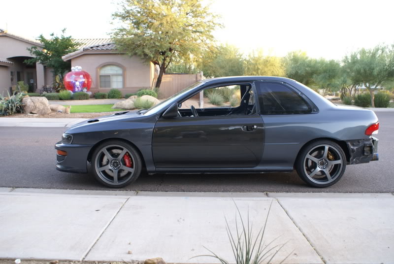

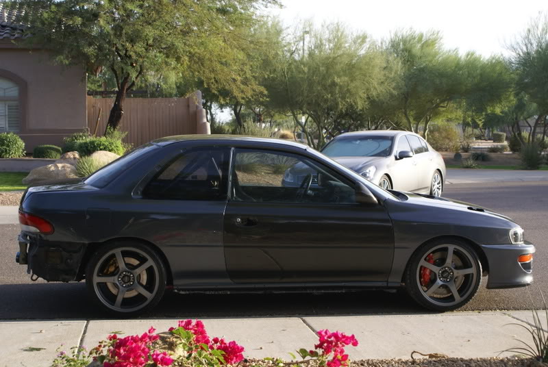

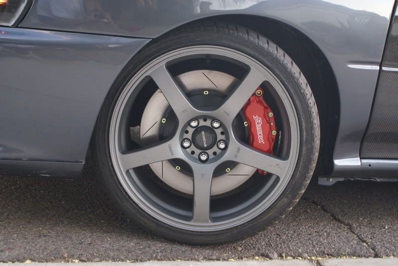

Went to do the corner balancing, but it was just about perfect the way I had it setup. ride height was all less than an 1/8" difference across the corners. Cross weight was 50.8% and front to rear was 61/39 F/R - Total weight 2697 lbs w/o driver and a full tank of gas (about 100 lbs of fuel), 2925 w/ driver (need to lose some weight! ) So I'm very pleased. Installed the Kartboy rear shifter bushing and the JIC Ti catback, sounds much better now.
Going for emissions in the morning, one step closer to a legal street monster! Gave it about half throttle to see how she pulls, Damn thing thing is a whole different beast than my last sedan, it feels like a monster, can't wait to get it tuned and see what it can do at the track!
The body is all painted, cleared, and wetsanded, getting polished Wed. Night. Both rear bumpers, front 22B vents, and hood scoop are getting painted this weekend. Still need to decide on what sideskirts to run, thinking something like the Zerosports pieces, I should be ordering them in a couple weeks once I go through all my options.

So the shell is all polished and waxed, looks awesome, I'll get some new pictures in the daytime. door handles, JDM rear plate holder, and JDM rear bumper should be painted on Mon.

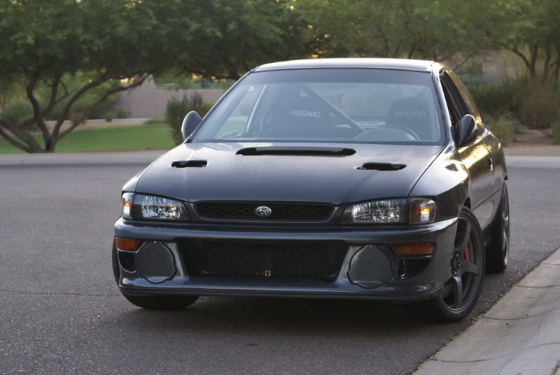

I waxed it last night, paint is awesome! Should be getting the vents, scoop, door handles (getting painted black), JDM rear plate bracket and rear bumper painted on Monday. The front bumper also still needs to be polished and buffed. The JDM bumper fits perfect with the exhaust, I just have to figure out how to mount the rear plate lights, there's no mounting points on the JDM bumper. Took a couple quick pictures of the interior, still needs to be cleaned a little more. going to install window trim and wipers after I get the rear bumper on. Should be close to inspection status by the end of next weekend, If I can get an alternator (hope that fixes voltage issues), and get the horn working.

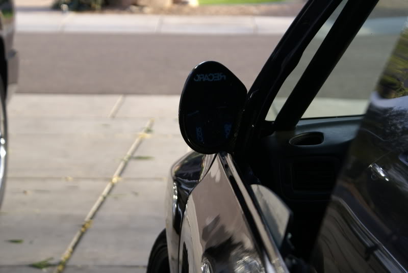

your car is looking great. how do you like those side mirrors?
Old Oct 22, 2007 | 08:33 AM
  #149
John2.5RS's Avatar
Posts: 361
From: SoCal
Car Info: 98RS coupe, Ver. 8 STI pwr'd
Thumbs up
Can't barely see anything, I think they might be for RHD. but they're more aerodynamic and lighter, so I like them! I have another lightweight rear view mirror for the interior I have to make a bracket for that should be helpful. It's a PITA to look over your shoulder to back up with 3" harnesses on!
