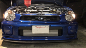

replaced the perrin aging fuel rail hoses with gates 5/16 e85 fuel injection hose. got a sleeve and otieker clamps. i have to reroute the fuel hose on the front of the engine due to the turbo is taking pretty much all the space behind the manifold.
still need to run couple vacuum hoses and i need to get a oil catch can for the crankcase and cylinder head vent hose.
almost there......

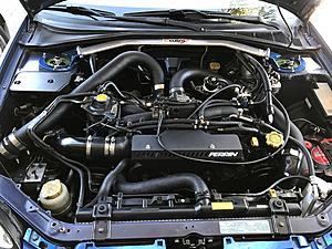

installed oil catch can for the crankcase and head vents .
changed the oil and added lucas break in additiv. road test and put 10 miles today. the 6 puck clutch is hard to engage on first gear , it feels like my first time driving a manual.
thanks to Travis@snailperformance for the base map, data log looks good . hopefully protune next week.

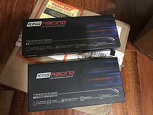

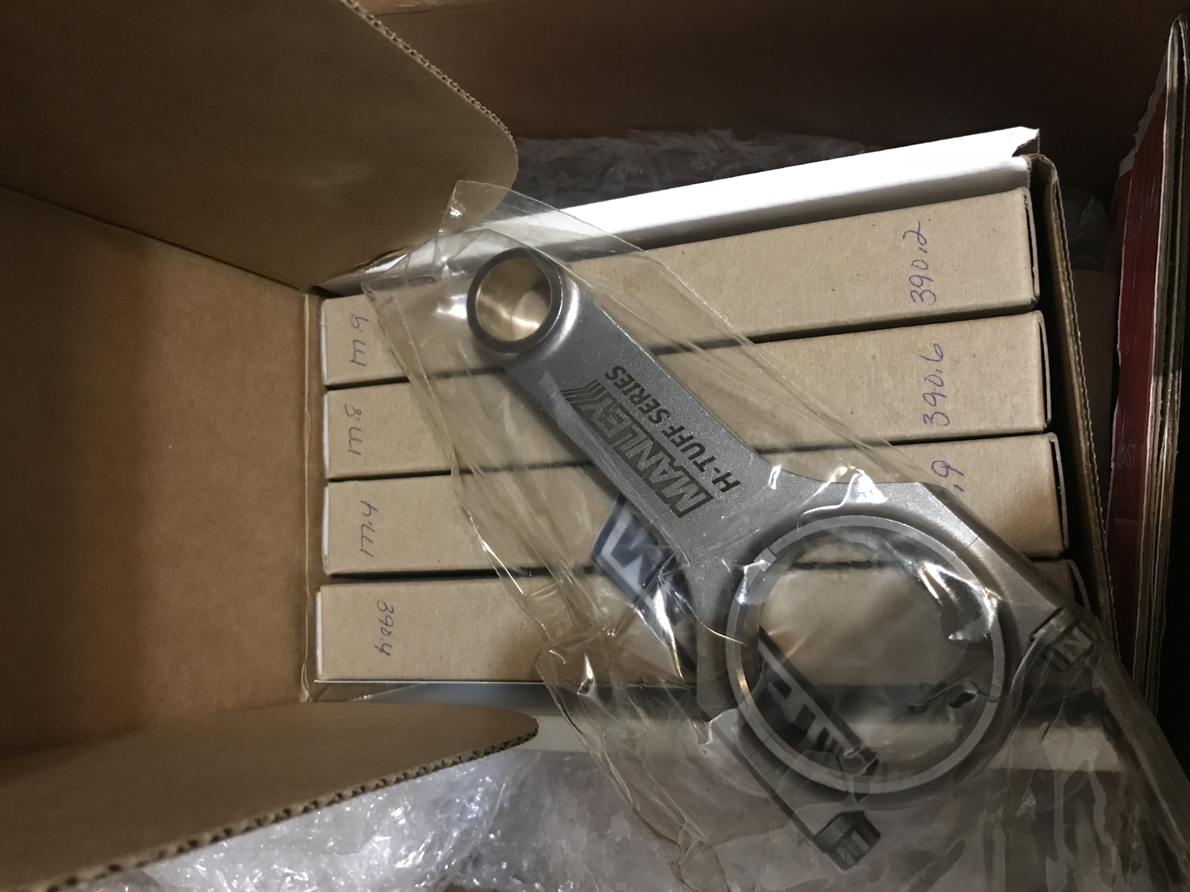

long story short the rod bearings decided to spun and ate the sti crank. got a used block and Adam@aamotorworks assembled it with new sti crank,manley h tuff rods, manley piston and king bearings.
Attached Thumbnails Project Bugeye stroker-img_2433.jpg   Project Bugeye stroker-img_2362.jpg   Project Bugeye stroker-img_2363.jpg   Project Bugeye stroker-img_2364.jpg   Project Bugeye stroker-img_2365.jpg

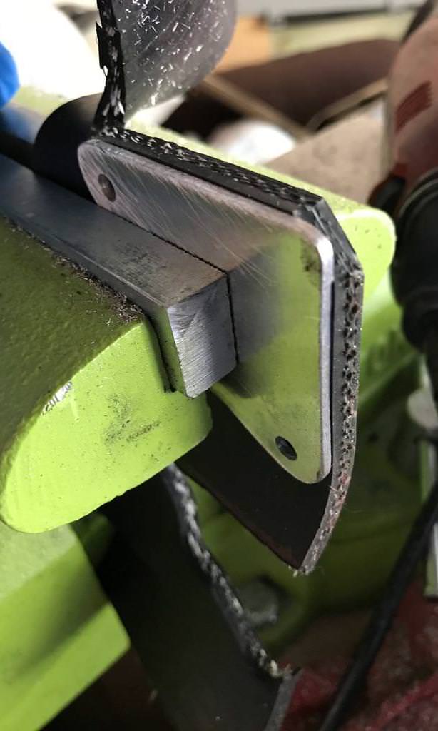

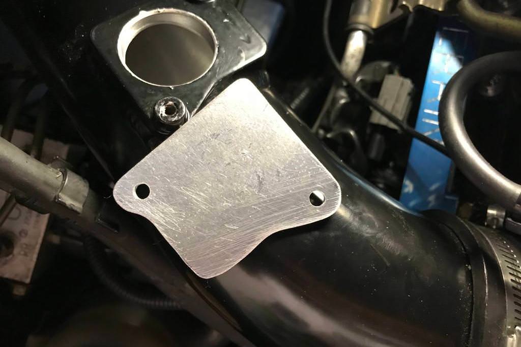

I was bored and decided to make a maf delete cover .i use a 3mm aluminum plate and intake rubber coupling from my junk bin.
painted it black and sandwich the rubber to seal the old maf hole.
