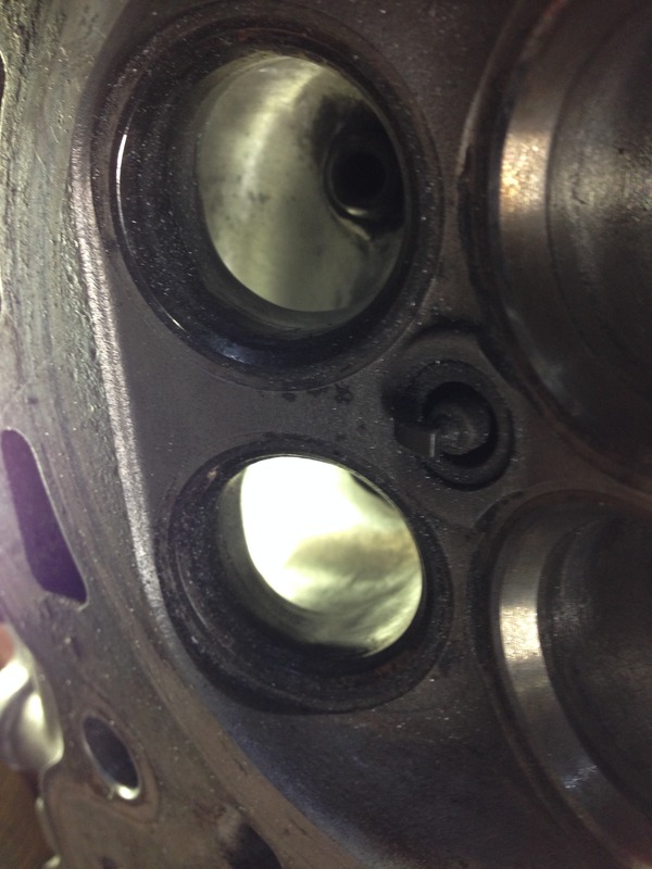

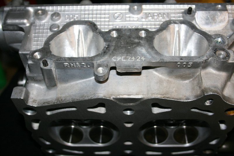

Old Feb 5, 2017 | 07:16 PM
lugnuts's Avatar
Joined: Jul 2014
Posts: 128
From: san jose
Car Info: 2002 wrx
Did some port and cleaning on intake and exhaust s20 head. ordered manley springs and retainers. for the the valves I'm getting supertech ss intake and inconel exhaust valve std.

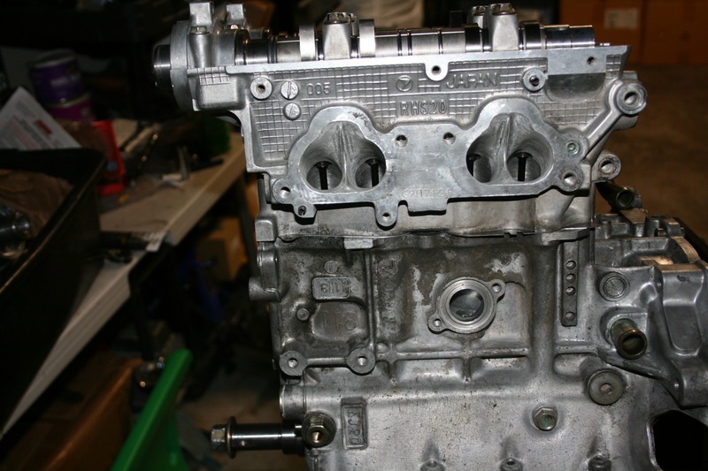

installed oem head gasket.
Torque ARP head studs bolts to 50-70-90 ft lbs
