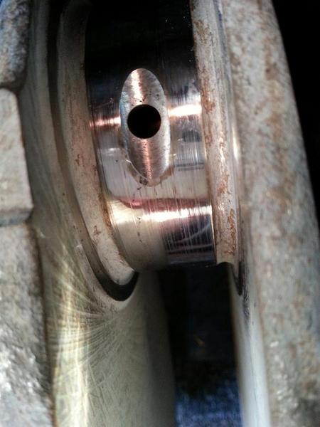

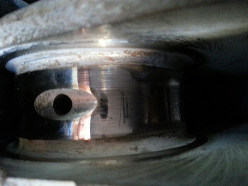

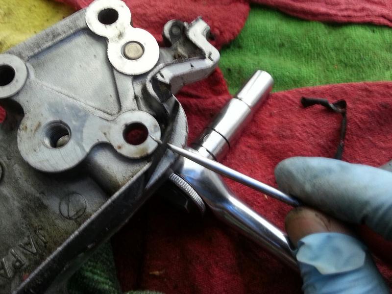

yesterday i had a productive day off prepping parts for assembly....only to find out my crankshaft and bores are worse than i thought
removing seal from tensioner "bracket"
#1 rod bearing with knicks:
Any reputable machine shop vendors able to chime in? im looking for a shop that can help me go about this. id rather not run ONE oversize bearing. TIA!
