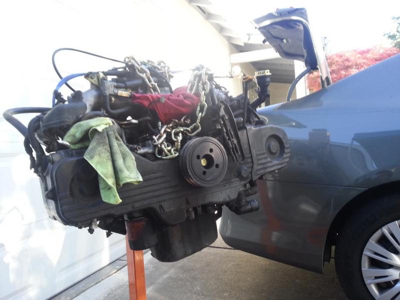

Any weekend warrior engine rebuilders out there? Im going to be pulling engine this week and have it on a stand by friday. at that point, im going to remove heads, and send over to maching shop to have them rebuild them. Im looking for someone to help me with shortblock. Measuring to be exact and just general questions. do i just buy new crank and pistons, etc without measuring or honing? or is it worth it to measure and reuse? i do not want to dump lots of $$$ into my RS engine. i just want to rebuild the engine myself with OEM internals. Ill be dumping $$$$$$$ into my forged internal STI engine. So, if there is someone out there that can lend a hand with measuring and figuring out what bearing etc. ill need, (possibly help close halves for good) it woulld be greatly appreciated. again, i mainly need help on the shortblock. after that im golden. but if u wanna stick around i aint kicking anyone out
PM if you are able to help out!

So i think i may take the day off tomm to pull the RS engine. I also have a list of things that need to be done to the scoob other than the engine pull:
1) adjust coilovers
2) remove Rally armor mud flaps
3) remove yakima mounts
4) swap wheels
5) install new headunit?
6) install new OEM STI rear roof vane?
7) find short in fog light circuit
obviously not all to be done in one day. but i at the very least am going to pull the engine within the next couple days. if anyone is willing or wanting to lend a hand for possibly lunch and beer, PM me. Help is always awesome, but not needed. Just giving the chance for someone like me (who loves wrenching on scoobs) to come and have fun. thanks in advance guys!
Also, still wondering about what Harry Maneuvers mentioned about the lack of needing to get measurements done. not even a hone with new rings?? can i get more feedback on this? thanks!

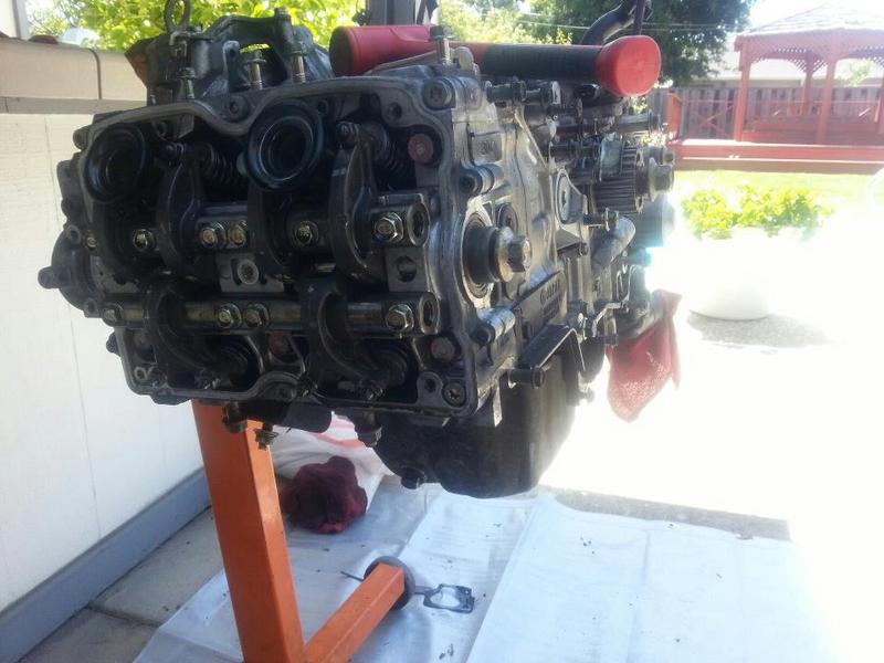

Im doing some reading up on my upcoming engine rebuild and im getting a lot of mixed ideas/answers:
-Do I need to balance crank,rods, pistons, etc after assembly with OE parts?
What i have recently found out: I will be honing cylinders as new rings will be going in. I also found out a couple easier/better? ways to measure clearances, of which ill will try and tackle myself. Am i missing anything?
-Tear down
-Inspect bearings and journals-order new bearing accordingly
-take block halves, crank, heads to machine shop to valve job/hone/clean/ balance?
-machine/polish crank?
-Double check clearances with new bearings installed
-Assemble shortblock
-Double check clearances in cyl.
again, my goal is to rebuild to OEM spec inside and out. No aftermarket parts or bearings. My car is a 2002 Subaru Impreza 2.5 RS with 255,000 miles on the odometer.
Prelim Parts List:
-New complete overhaul gasket set
-new piston rings
-new main/rod bearings
-new oil pump
-new water pump
-new thermostat
-new timing belt/tensioner/pulleys
what you guys think? given my situation:
Should i re-balance/polish crank? im already taking block halves to machine shop for clean and hone (or should i do it myself) and head job. how much more would it be to regrind (if no visible damage) and balance if needed? i know. so many questions. but after doing much research, i am now out of the clueless stage to the indecisive stage. LOL

^some cleaning to do
as well as inspect hoses. may just end up replacing them all.
^engine out and ready for teardown
^^intake mani removed. note the tags placed on various hoses, harnesses, etc.
^timing
^cam cogs, idlers/tensioner, and belt removed
^doneso coolant crossover O-rings
^SOHC heads
^MMMMMM carbon. LOL
