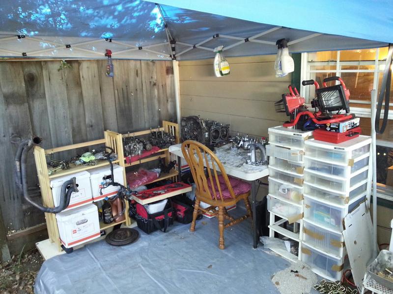

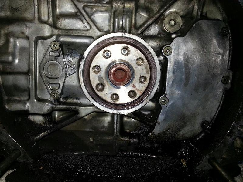

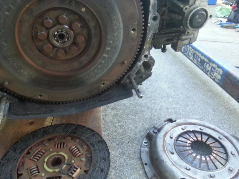

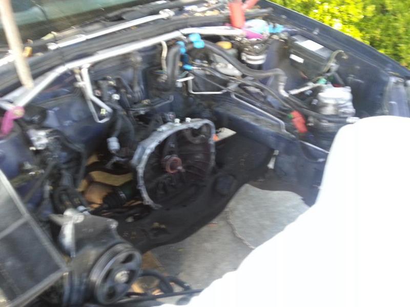

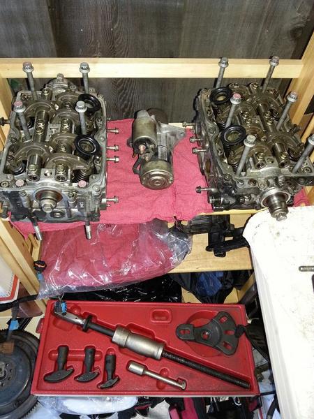

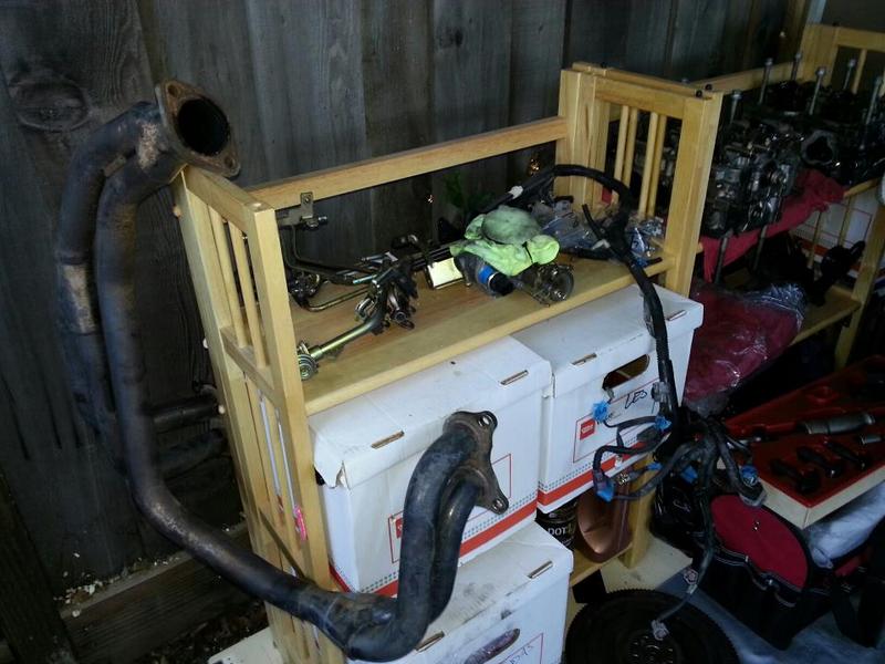

update on oil cooler or thread? i didnt really do much to the build this past weekend as im trying to make a sales tax deadline tomorrow. What i DID do is bring my engine and parts over to my place to finish the build. I also had sometime to wash the whips

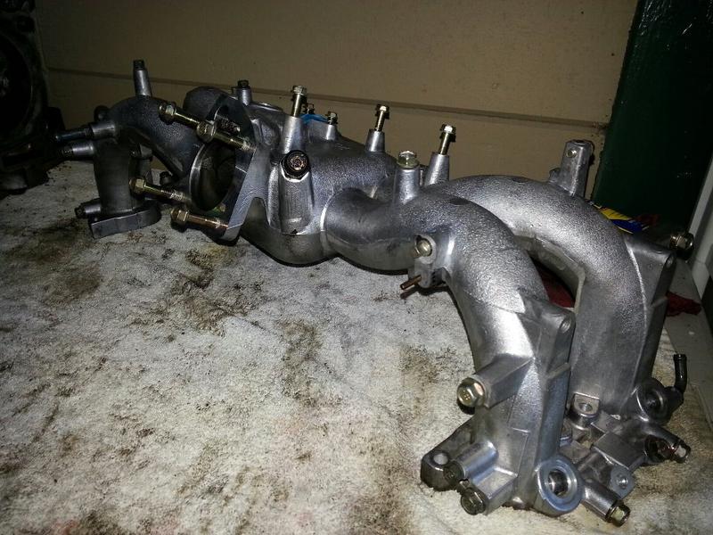

^also got to cleaning intake manifold a bit.

IM STUCK AT WRIST PINS! LOL. my ghetto fabulous puller didnt work. so now i have no choice but to either: make another one, spend $200 on OE tool, or PUSH pins out from other side. Even then, ive been soaking those screws for access holes in PB and still they wanna strip...

Also, by the looks of it... your rear oil separator plate was leaking pretty good.

cool! thanks for the help bud. im actually going to go with push method as i spent a cool 2 hours on one pin with my DIY puller. now its time to push....but in order to push i gotta get those covers off. and ya, no leaks or damage. was pretty impressed, sisnce u mentioned they tend to leak. itll be replaced anyways

I was saying that it looks like the separator plate IS leaking. The picture is dark at the bottom but it looks like it is leaking from the bottom of the plate hence all of the black crud that has collected at the bottom of the bellhousing.
thats actually CV joint love juice. LOL. CV boot was torn for days and never repalced half shaft. the grease flung upwards into ringgear opening at bottom.

That is definitely not from a broken CV axle. That is 10's of thousands of miles worth of a slow leak.
1. the hole at the bottom of your bellhousing faces down. Your axles are above, behind and to the side of that opening
2. Your CV boots rotate completely perpendicular to that opening (not to mention above, behind and to the side of it).
3 You would have soaked the outermost portions of your clutch/flywheel if it somehow came from outside of your bell housing.
From your own picture you can see how impossible it would be for CV boot grease to rotationally sling itself off of your rotating axle and into that small opening at the bottom of your bellhousing and up onto the back of your motor.

hmmmm. ill look into that and take closer up pics when im at the car next. only reason i suspected the black grime under the seperator plate was due to the thickness of the crap. once i actually clean that area up, ill know if it indeed was a leak at the plate. judging by what you say, you could be right. but let me tell you, when the engine was running and t he bay was full, the grease from the CV joint sprayed all the way up the backside of my pass side head. all that black speckled looking stuff deff came from the CV. i know that much
either way, in the end, both are getting replaced. LOL. but deff worth finding the tru reason behind this.
