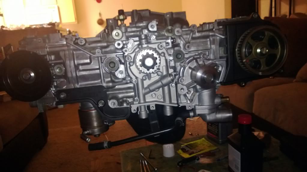

Yes you have an oil cooler. It should be what your oil filter spins up and seals against.
Like this:
It is the round piece on the bottom, passenger side of the block. It has one of the coolant hoses disconnected and you can see the orange o-ring at the top where it sits against the block (the filter post is not tightened down on the picture).
Like this:

Well now I am confused. I checked the FSM for a 2001 Legacy which is the EJ251 like I have but it doesnt show an oil cooler anywhere. I am wondering if my engine is maybe a little newer than I thought!
#45
all good. i kinda figured the oil cooler was specific to either: year/aspiration/tranny (MT vs AT) i say tranny becaue there are certain parts the relate with eachother. such as AT sharing cooling from rad for both engine and tranny.
if anyone knows a definite answer to this, please chime in. i know i dont have an oil cooler so it "dont really matter" but in terms of education sake. what cars/models use the oil cooler?
