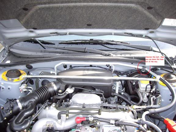

Most likely you will have to move the AC hoses.
Are you talking about the front tower bar?

Hey J, I'm got a bar on order, and been tring to figure out how to do it as well, It looks like you just move the line at the point the ruber spacer was holding it down to on top of that point, or did you have to do more?

You have to unscrew the bolt, in which I've indicated on the above pictures.
That allows you to move the metallic hose around, and thus freeing up some space to install the tower bar.
You MAY have to drill an extra hole for the bolt in which you unscrewed earlier, only if you wish to move that bolt to a different location if needed.

OK so i spent a whole deal of time on this.
If any of you ardered the wrx/sti bar like i did, return it or resell it.
Your bar in the pics faces the front of the car, the wrx.sti one sits agaist the firewall almost to allow for room for the intercooler. the right side hose i can move, but there is no moving it on the left side unless i want to start bending the metal part of the hose...

With regards to the tower bar, try reversing it so it sticks out towards the engine. Regardless, it's still a metallic bar which increases ridgity.
