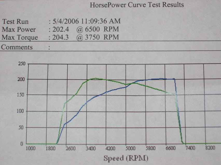

If you are thinking about a bigger intercooler on the stock turbo, you should have a catless exhaust and custom tune.
A bigger IC on the stock turbo (WITH tune and exhuast!) will be an awesome street setup! It will spool faster and boost harder when tuned right.
I have this setup and its great. 16-18lbs of boost comes on quick and holds through out most of the rev range
This was with 55K miles, up, TBE w/high flow cat, silicone IC hoses, TurboXS TMIC and custom ecutek by Mike @ gruppe-s on 91 octane. I believe this is about 10-15 hp/tq short of a stock sti

How long were you on it for in this pic? EGT's look kind of low. You might be able to lean out some of those ponies for bigger gains.
Not very long...I was trying to take a pic that shows the most boost at the lowest rpm. This was 4th gear.
You're right about leaving some hp on the table...my car wasnt running so great when I brought it in to get tuned. Mike didnt want to do any thing "too crazy" so he left me with a more conservative tune. It still kicks butt though! EGT's get the hottest ~ 1600, after flooring it on the freeway during top speed runs.
I want to have it retuned but I will just wait and save my money for a vf22, pinks and fuel pump. Then have some real gains

Great numbers man!
Looks just shy of what a STI is making.
