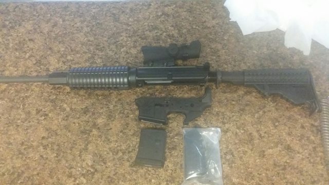

Laid everything out this morning, just to take inventory:
Spike's Calico Jack stripped lower
Bushnell 1x32 Red Dot (bought from a fellow i-clubbers)
DPMS 16" Sportical Kit (smooth sided upper, DPMS Pardus Stock, DPMS LPK)
2 MagPul 10rd PMags
CoiTAC Bullet button

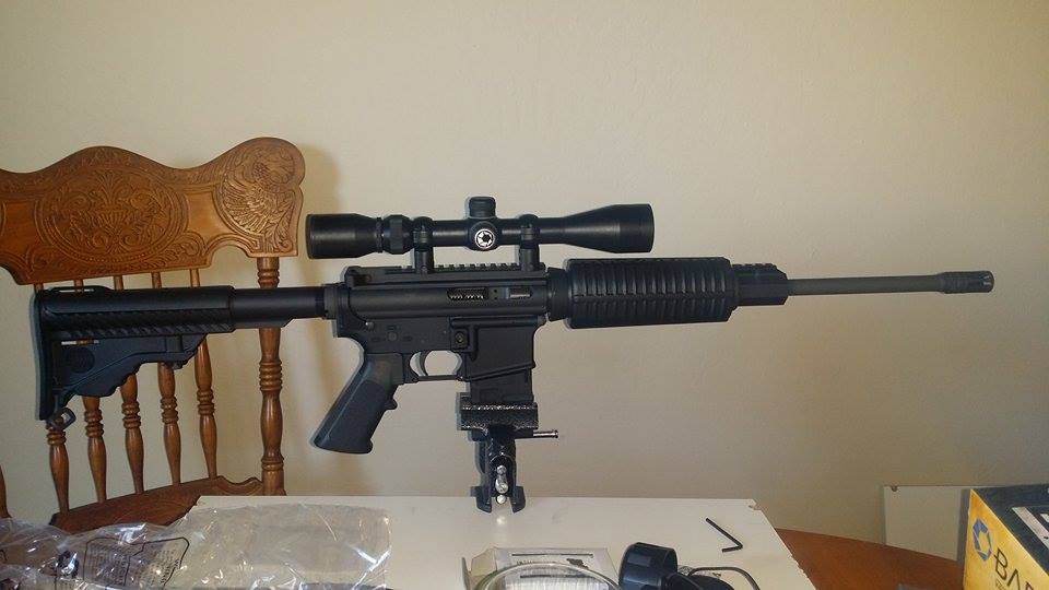

Finished my lower tonight, went to attach it to my upper, and the pivot pin will snap closed just fine, but the takedown pin doesn't want to go all the way. I don't want to force it, but is this something that is 'normal'?

Yeah, turns out it's a known issues with Spike's lowers, the hole for the takedown pin is just a shade smaller than most other lowers, so there's a bit of tightness when attaching the upper. Gave it a little bit of Hoppe's lubricating oil, and a few smacks with the nylon hammer, and it slid in. Still able to drive it out with a punch from the other side, so it isn't totally bound up.
Took it out this weekend, put about 150 rounds downrange without a single hiccup. I was using the red dot I bought, but I was digging through my closet today and found this:
It's a Barska 3-9x40 that I forgot I had. Got it attached, and gonna take it out this weekend to see how it compares to the red dot.
