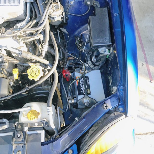

Bunch of updates and stuff finally installed. Got the Koyo radiator, IAG Street AOS, Deka mini battery, and Schroth harness in. Plus I removed a bunch of weight to see how much different the car feels without it. Weeeee!!
