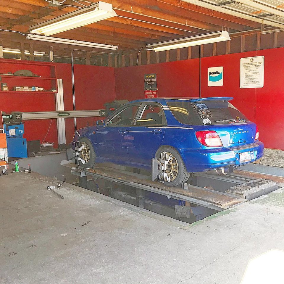

Had some equipment issues with getting the alignment perfectly dialed (losing the rear camber bolts and need to investigate why I only have limited front camber), but got it good enough to rock for autocross this weekend. Rolling on goldies for now while I still sort the flare stuff.

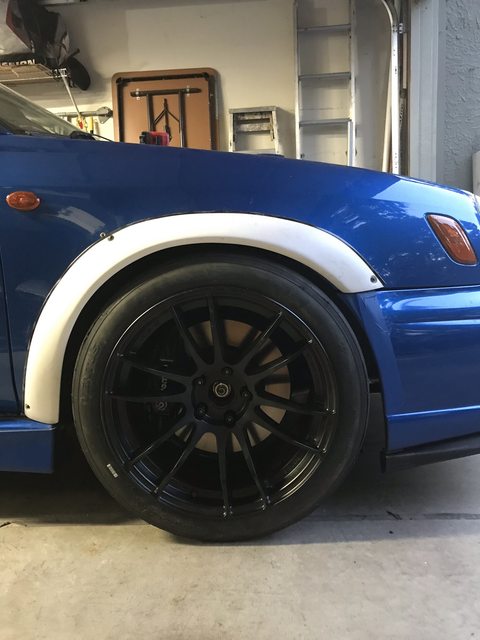

But the real fun was had by the other additions. Got set of brand new 275/35 C91s on slightly used 18x10.5 +22 57Xtremes from Travis who made me a deal I couldn't pass up. This gave me an excuse to finally get the Subyflares installed. Behold the following—

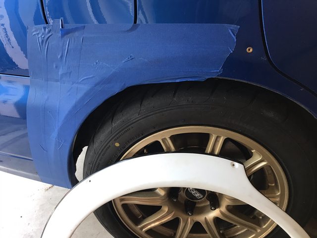

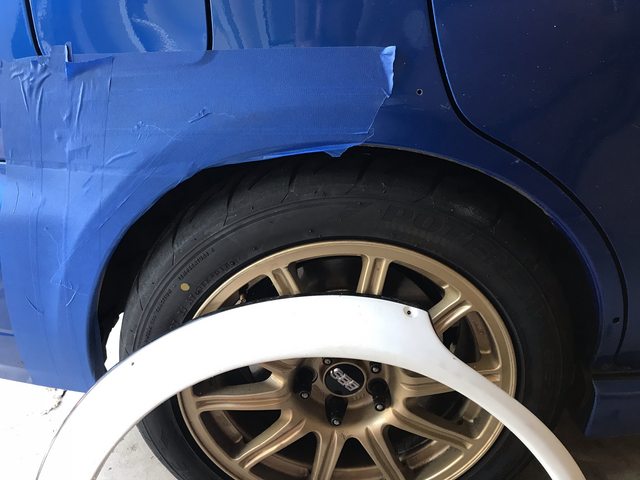

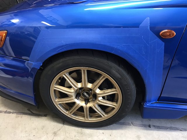

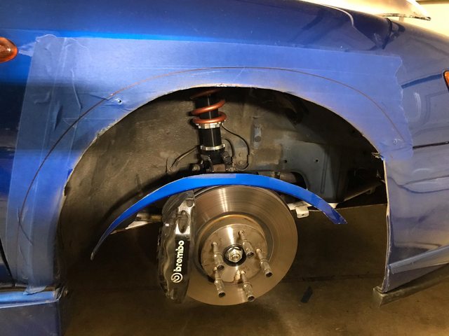

Tape off area to make marks and such, and to protect the paint:

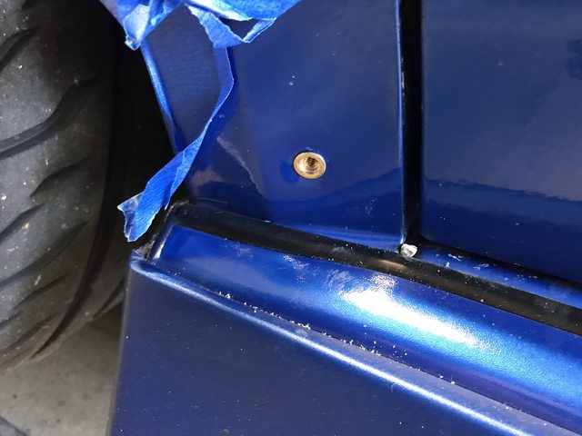

The second last point-of-no-return, drilling holes for the rivets:
Paint the holes to protect from rusting:

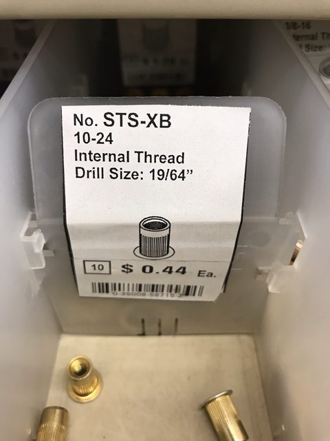

I used internal thread rivets to make installation easy and, more importantly, make the flares removable:
Do for all mounting points:
I added some rubber trim to protect the paint and clean up the look. Then, mount:
Move to the rear, rinse, and repeat:

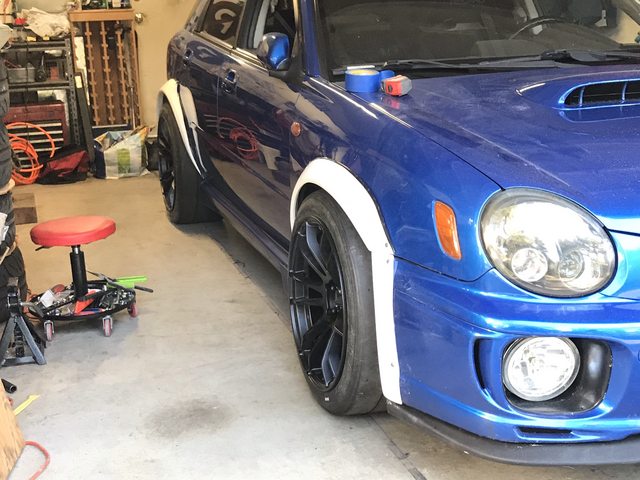

Intermediate step. Install isn’t perfect and will require much... MUCH... more adjusting, trimming, fitting, cussing, etc.:
Now, the truly painful part—cutting:

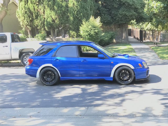

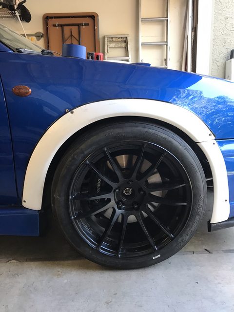

Once everything was cut, clearance, and trimmed to my liking, and pulling the flare forward (ignore the old rivet hanging out), fit front valence:

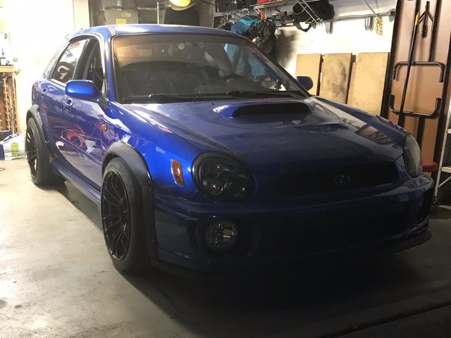

Had autocross the next morning and still undecided on color, I just hit it with a few layers of black primer:
Not really wanting to drive the 90 miles to THill on slicks, on to the trailer he goes (gender-fluid import model came with the trailer):
Toby ready for launch at autocross looking all serious and mean:
Got some good video at autocross to put together that I will post later.

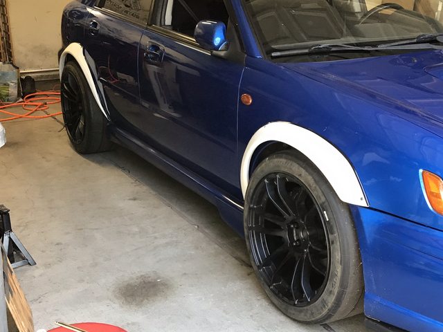

Final thoughts on the Subyflares: It is *almost* blasphemous to call these “Karltons”. Yes, they are based on Karlton molds, but these are fiberglass and not ABS which makes working with them a bit more challenging. These are almost “knock-off” quality when compared to the original Karltons when it comes to fit and finish. In the end, they work. They’re kinda close, but they take a lot of work. A lot. Not just some minor trimming and massaging, but a lot of trimming. Granted, I went into this a bit blind, but for the price and riding the coattails of the Karlton’s reputation, a little additional time and QA/QC could go a long way into justifying the cost. If I had to do it all over, I would go with ABW. /soapbox
Back to our regularly schedule programming: Toby flies on slicks! So much grip! The super wide meats make turn-in a bit vague requiring much more input and response a bit slower. The trade off, however, HOLY ****. I was able to carry so much more speed than anticipated through sections that I could (should) have grabbed third instead of riding the limiter. Still playing with pressures to see where the sweet spot is, but cars I am usually three to four seconds behind on minute(ish)-long courses were only ahead of me by within one to two seconds or less.

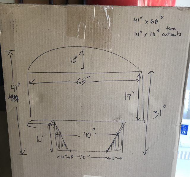

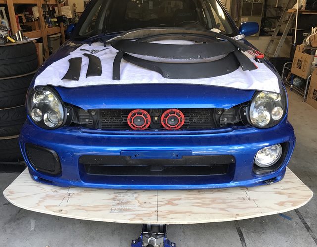

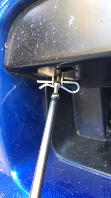

Here is the rough schematic I started with using quick measurements and maxing out allowable specs per SCCA SM-class rules:
I didn't get a picture of it, but the trick part came trying to cut the front curve of the splitter. After cuting the tire cutouts I had a big T-shaped piece. I used a jack to hold up the plywood to the underside of the car and "finessed" it into place making sure it straight and square with the centerline of the car. With the bumper cover still on, I used a plum bob and giant T-square to trace out the bodyline and added 6" away while staying within the width of the car as allowed by the rules. I then cut that line and held it back up under the car with a jack to double check I was within the 6" rule:
Taking the bumper cover for ease of access, I then aligned and placed the chassis mounts (6" x 6" brackets on top bolted through the plywood and tied underneath with the 12" straps for over-engineering) which were bolted to the front frame rails (1/4"-20 threadserts into the frame rail near the radiator support) and added the front support rods.
[img]https://i.imgur.com/YJwFBKXl.jpg[limg]
The bumper cover has convenient holes that allow access to the underside of the front bumper beam. I mount the U-brackets for the support rods and replaced the hardware with the hitch pin to make removal easy*:
*Note about this: Taking the front bumper cover on and off becomes a little challenging trying to get it over the U-brackets. I actually bent one of them in a rush to get the cover on so I might be taking a Dremel to this area to make getting the cover over the U-bracket easier.
Everything bolted up, I had to do the highly-technical and scientific "Is it legit?" test:
At worst, there was only a few millimeters of play (difference in diameter between the holes and the hitch pins) with my fat *** standing on it, but feels solid otherwise.
Last step, obviously, hit with as much paint as you want--go crazy with it. And here is how mine turned out:
I'm very happy with how it turned out. A few notes for some future adjustments or changes:
For "street cred", stop here.
For practical application, keep going.
The function of a splitter is basically an upside-down wing. The flat surface allows for air to move quickly under the car and an air dam, or the front of the car, slows air moving over the top of the splitter. The velocity differential creates a net forces downward (slower air speed/higher pressure on top, faster air speed/lower air pressure underneath)--more downforce, more grip. The way I designed mine had a key component missing: an air dam on top. Since this was quick and dirty project, I didn't have the opportunity, prior to autocross, to run to the hardware store to fabricate a solution since it was 0800 Sunday and we were already up at Thunderhill, so we improvised. Here's where the unicorn duct tape comes in:
Stylish and functional. Can't beat that.
- As you can see it's not perfectly level with the ground. The splitter extends so far back that it hits the skid plate which is lower than the radiator support. I want to mount the whole splitter lower so switching to longer chassis mount brackets will hopefully solve this, but that may necessitate either (a) longer support rods or (b) moving the support rod mounts on the splitter closer to the car. Option A is more ideal (if I can find 15" support rods or somehow fabricate my own) as Option B will limit pitch adjustability. I also want to add a tie strap under the support rod mounts to really solidify the forward mounting.
- As for the current chassis mounts, they require removing the front bumper cover which, while not a huge pain in the ***, is less than ideal so further exploration and experimentation is needed there.
- Once everything is where I want it, we go alumalite!

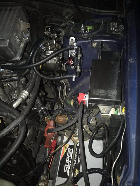

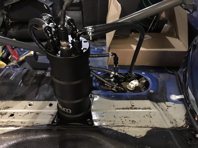

Ethanol sensor was about as easy as they come. Ethanol sensor goes inline between the engine bay fuel filter and intake manifold fuel lines with three plugs on the harness: one for the sensor, one for the rear O2 sensor, and one for the front driver TGV. Put the "brain" in the cab near the filler cover release and ran the cables back out to the engine bay via the grommeted hole behind the pedals.
Had to get creative with the fuel lines and AN fittings to plumb the fuel surge tank to keep it relatively neat. Used Earl's vapor guard fuel line and AN fittings from Earl's and Racetronix:
- From in-tank push pump 5/16" quick connect (QC) female 90-degree to male -6AN, -6AN female 90-degree to -6AN female, -6AN male to 5/16" Vapor Guard straight male
- From return line 5/16" Vapor Guard straight male to -6AN male, -6AN female 150-degree to -6AN female, -6AN male to 5/16" Vapor Guard straight male
- To in-tank return, 5/16" Vapor Guard fuel line onto spigot
- To engine 5/16" QC male to -6AN male, -6AN female 90-degree to -6AN female, -6AN male to 5/16" Vapor Guard straight male
All four run 5/16" Vapor Guard fuel line up to -6AN female 90-degree to -6AN female attaching to the four -6AN male fittings on the FST
Did thread rivets into the floor pan and bolted the FST down. Had iWire do a plug-and-play harness for the FST and a second fuel pump controller for the fuel pump in the FST. Everything wired up nicely, ran cables up to the front for constant and switched power. Checked pressures after filling the FST and didn't see or smell any leaks.
Got a date with Travis in a few weeks for some flex fuel tuning and some other fun "extras" to go with the tune.

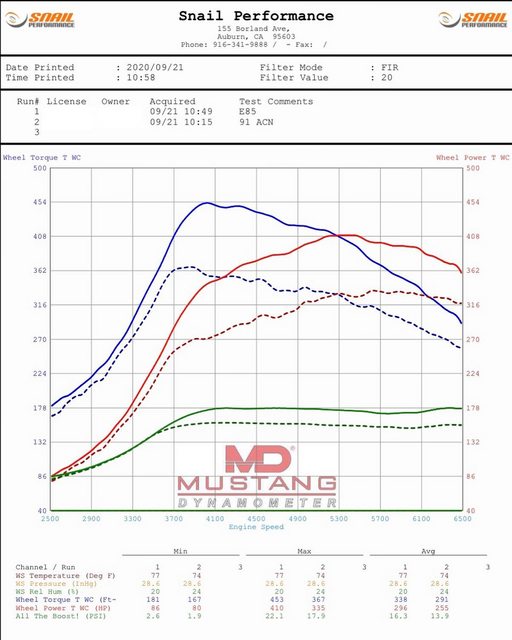

Travis did his thing. Switched the ROM over to Carberry and cranked it up. Dashed line is on 91ACN (pump gas) at 17 psi, solid line is on E85 (closer to E70) at 22 psi.
