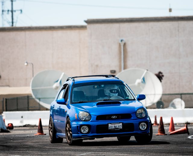

Finally, I go to smash on the RE-71Rs at autocross (pics below). These tires are amazing. They heat up and are grippy after about 15 feet, and don't let up. After the first lap or so, in some corners where I was expecting a lot of push if I were still on the R-S3s, the RE-71Rs stayed hooked up and gave me a lot more grip than I was expecting. Set them to 30 psi cold, came back after a lap where they got up to 35 psi hot, reset them to 32 psi, and they managed to stay there throughout the day with no additional adjustment. Never really did find the edge, but did manage to get some push when I aired them out too much down to 28 psi hot.
My only complaint is they are starting to chunk on the inside corner of the main water channels after 4 miles of autocross where I hadn't noticed any unusual wear for the 750 or so miles since putting them on prior to this weekend. We'll see how they hold up.
Other than that, I'm am very satisfied with these tires. Gonna have to get a set for Nicole's car, too. lol
Amazing pictures by IG@kevthephotographer:

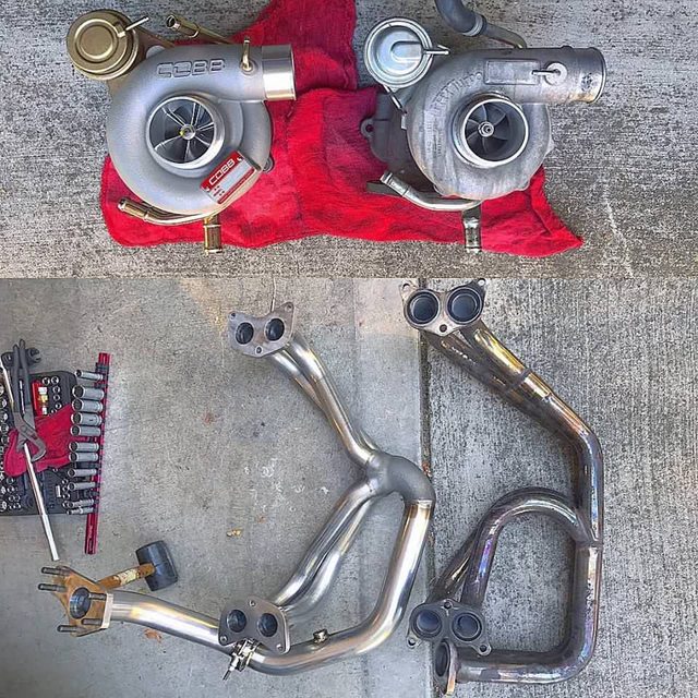

The VF-48 **** itself. This was remedied by a brand spanking new Cobb 20g. I also took the opportunity to ditch the Perrin header and swap an absolutely gorgeous piece, the Killer B 4-1 v-band Holy Header.
Got the turbo and header in a few weekends back, got tuned up by Travis at Snail, and this thing ****ing scoots.
Ran out room with the ID1000s to keep turning it up, but managed to make about 330 whp and 360 ft-lbs on E85 at about 17 psi. It makes about the same about of power as the VF-48, but that turbo was maxed to within inches of it's life (probably why it finally **** itself) and the 20g is just barely turned up. For now, everything works, but will definitely need injectors -- thinking ID1300s -- and possibly a bigger/better intercooler ("Hello, GrimmSpeed?") to really turn this bad boy up. Weren't able to get too many pulls in because the rear was squatting so much causing the tires to rub on the fenders, the car looked like it was doing a burnout on the dyno and filling the dyno room with smoke. lol Need to raise the back, stiffen the suspension and/or find narrower tires before the next dyno session.
