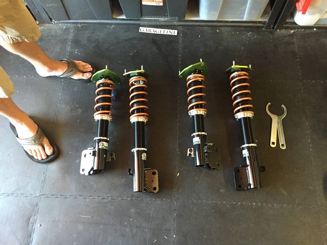

Finally pulled the trigger on a big kid suspension:
Feal 441 kit with 7k/5k springs. Didn't go crazy lowering, but I set it just a bit lower than in the picture below. I'll get better pictures up later.

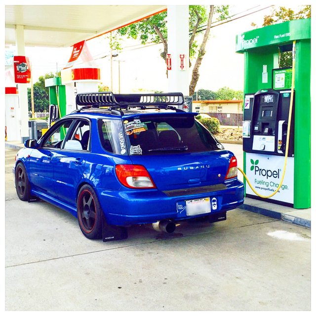

Also, switched over to a Greddy Evo catback. The piping hangs a bit low so I might go back.

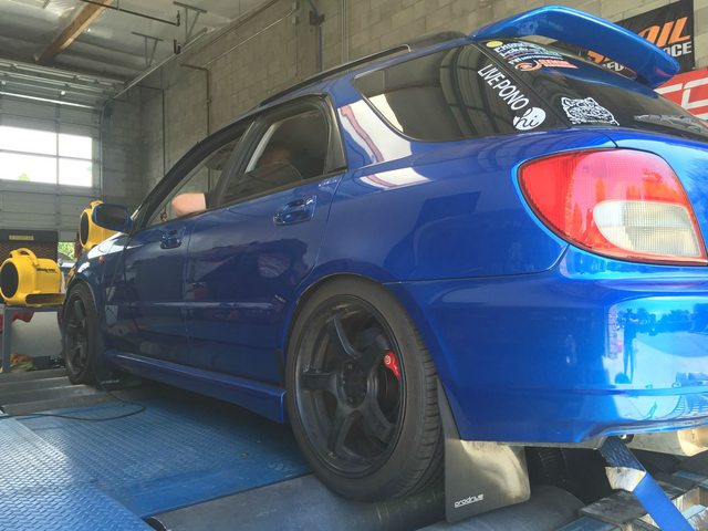

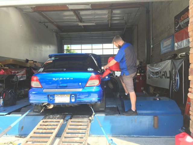

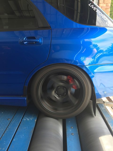

Just got back from FW where Travis was able to work his magic now that all leaks and hiccups were fixed.
Up from 300 whp/350 ft-lbs last 2/2014 and adding the 6MT, Perrin ELH, ID1000s and E85, car put down a solid 330 whp and 400 ft-lbs of torque. The torque peak shifted down and picked up a massive 50 ft-lbs with the newest additions. The poor little VF is choked out peaking at about 20 psi tapering to 16 psi. It is definitely the bottleneck now and, in fact, you can actually hear it chopping a bit under heavy load.
1.5 Dom or 3076R down the road perhaps?
Overall, extremely happy with the tune. New suspension, new tires, new tune.. autocross should be huge fun. GoPro vids to come after this weekend.

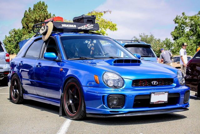

Favorite snap of Toby from BAM2k15. PC to Victoria Savage.

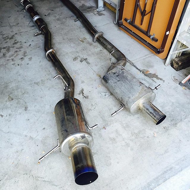

Traded the Evo 2 for a G200.
And if you're counting, this is the 7th turboback/catback exhaust setup, not counting stock. Don't judge me.
