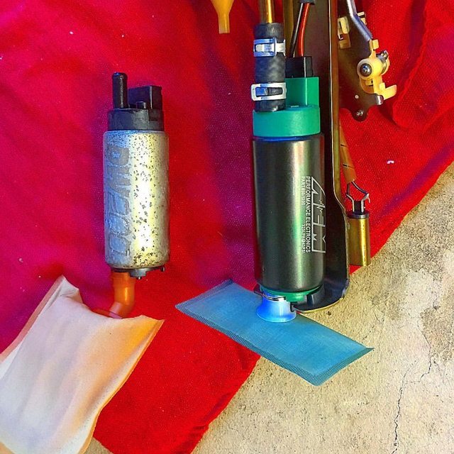

After about 15 months and 10,000 miles of approximately equal use on 91 and E85, the DW200 fuel pump gave up the ghost.
DW claims the DW200 was E85-compatible. I have evidence to the contrary. Trading emails with them as we speak.
In any event, the AEM is in. We'll see how well it holds up.

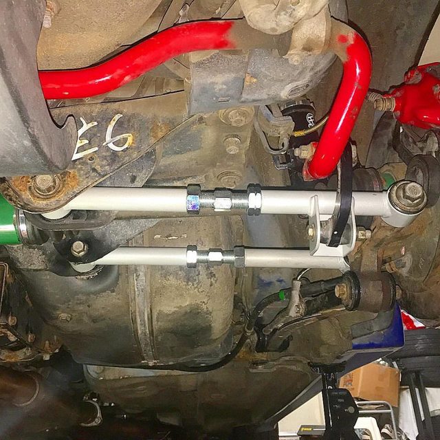

Updated pictures of the lateral links:
And this bad boy installed:

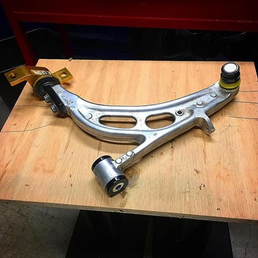

Good news, though: finally got the OEM front bushings and sleeves out of the front control arms (amazing what the right tools will do) and the Whiteline bushings in so these bad boys will be going in soon (I hope):

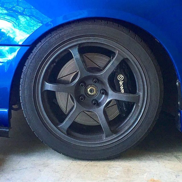

Other projects: While I had everything disassembled, I had the front wheel bearings replaced and (finally) swapped out the red Brembos for the black Brembos from a 2007 STi Limited--this was a two-fold fix: (1) the company that rebuilt the red Brembos did an absolute **** job "repairing" the mounting threads as the helicoils were pulling out and (2) I very much like the look of the black calipers better. Observe the approximately 4.5 degrees of caster:

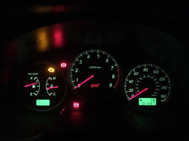

FINALLY have a fancier instrument cluster that works! Sourced a correct-ish mileage EDM Prodrive STi cluster (from Lithuania o_0), plugged in, and go! Center tach, shift light and buzzer, AOT display (need to build and wire in circuit--summer project). Everything I need/want.

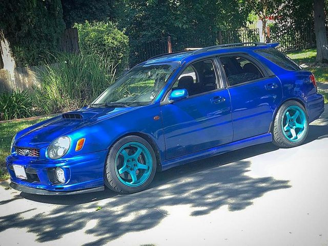

I seem to be going through wheels a lot lately. Newest acquisitions:
17x9 +42 Rota RT5 in ridiculous teal. Same size and offset as the DPTs I picked up, but the paint on those was.. rough.. so they will be going off to powder coat later on. I got these because of the size, but they are definitely an acquired taste when it comes to color. When I initially put them on, my first thought was, "Dear, God. What have I done?" Going several days now, I'm really liking them.
In addition to the wheels, I mounted the 245/40 Bridgestone RE-71Rs I just got on them. These tires are sticky. Very sticky. I love it. They have a bit of a hum, but those more knowledgeable than me said it's just the mold release coating that will wear of in a week or two and then they will be about as loud as the R-S3s.
Initial impressions:
- way stickier than the R-S3 V2s, even when new.
- much stiffer sidewall for crisper and more precise turn-in.
- loud.
More to follow the next autocross.
