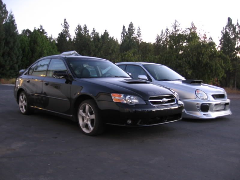

ok here is the impreza hiding behind my buddys LGT
