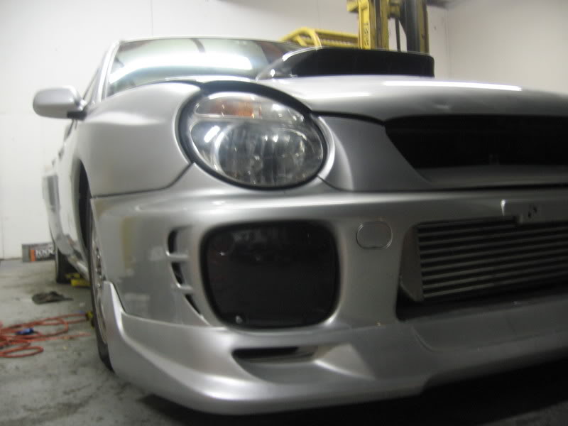

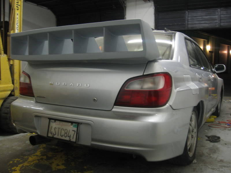

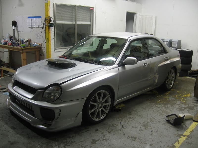

ok here are some shots of the car today the stock hood wont shut because I did the intercooler pipeing for my Kakumei hood so now it wont close all the way
so I will just run my hoodpins on the oem hood. I played alittle with the grill and ran some more VAC lines so I still have to get the right size belt for the alt and do my intake and then I will be ready to start. I have to find an intake that will work with my avo turbo inlet hose(3") and also with the greddy fmic kit then after my breakin when I get dyno tuned I am going to move the MAF to the cold side of the intercoolerpiping.
