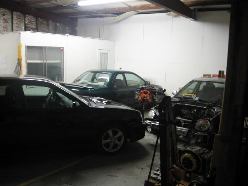

WOOT geting there

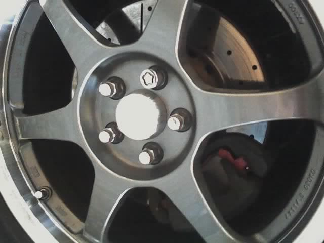

LOL yeah I guess in every pic I put up I have the stokers on. I have 2 other sets of rims some SSR's and some kaz.... somethings lol. I am going to get some new ones with the right offset. these are the only shots of the rims I have the SSR' on my silver wrx and the kaz 18's on my black wrx.

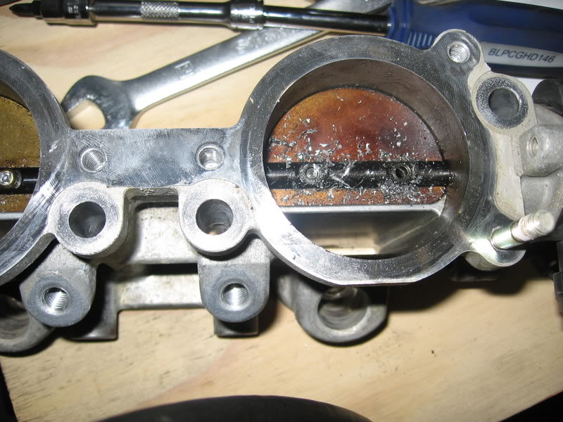

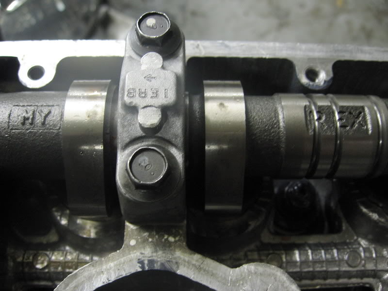

ok so I am still doing the swap here are some pics. I am takein out the TGV's and also porting the risors yeah. oh yeah I thought you guys would liket he code on my V7 sti cams LOL MY REX LOL

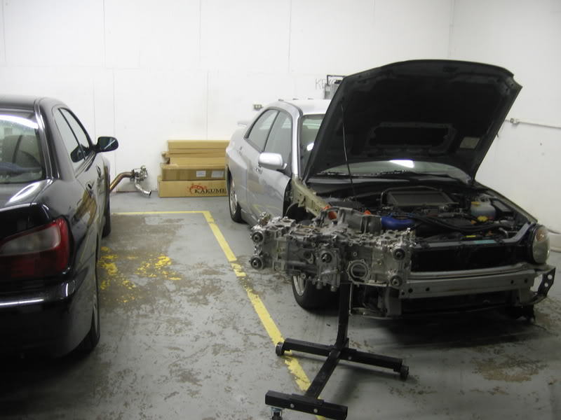

ok guys I know this is taking longer then I want but things are getting done right. no cheap and quick slaped together car for me. so if you cant tell form the pic we did rotate the intake manifold. Let me tell you the only thing I could get out of most shops that do this is "well you have to move the altenater" and that was about it. HAHAHAHAHAHAHA I wish it was that easy. So we dove in to it with out knowing that much. fuel lines, wiring, triming the intake manifold of the bracket studs and alot more come into play not to mention coolent lines and all the new lines that we have to do for the breather ports (2extra on the sti heads) and other tubing. but after about 7 hrs on just the intake manifold we figured out most of it. we still have a little bit to do but not much.

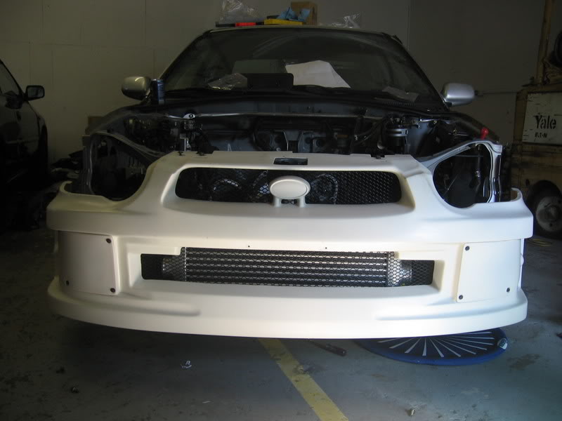

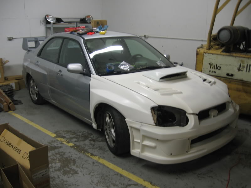

ok so I lied about doing the 02 wrc kit. (well I did not lie I just am doing something diferent. Let me know what you guys think. and what you think I need to go with every thing. the things I have that are not shown are rims side skirts a rear bumper and EDM headlight (on the way). The GC is going to be put off for a bit and just fixed up stock to give my GF a car to drive in the snow. anyways the pics down below are of the parts just siting on the car. no bolts no nothing. so dont think that is how they fit haha. I just picked them all up and set them on to get an idea of what it will look like. I think it will turn out ok. The motor is going slow as we are waiting on some plugs for the AVCS sensors and cam sensors. BIG PROPS TO SEAN!!!!! at ralli tek he is the man for havin a big *** bucket of plugs in the shop anyway let me know what you guys think and if you think I sould do anything else. I think I am going silver and black (black from the botom of the windows up and also the hood trunk and wing. that way when I tint the windows it will look sick. and I realy want to do it because of the old school SVX. the silver one with the black top was just one of my facoret cars growing up.

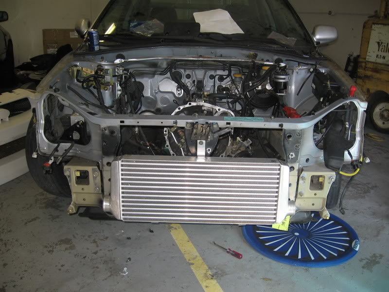

ok it is here yeehaa now I am just waiting for my pipeing and I will modify it to work with my rotated intakemanifold. and try to shorten up as much of the piping as I can
