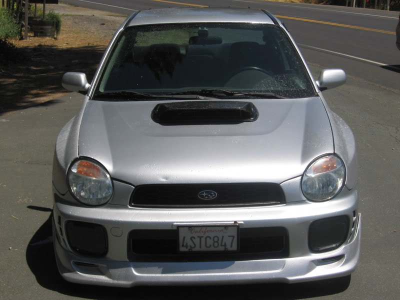

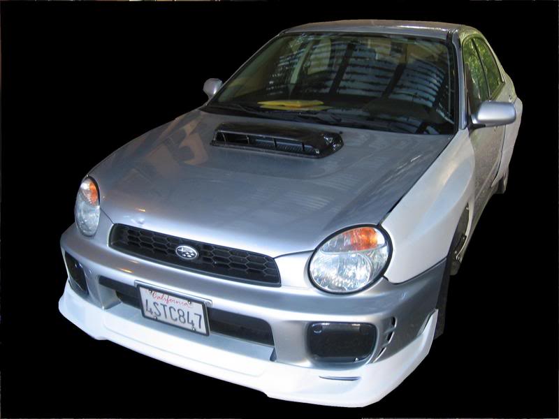

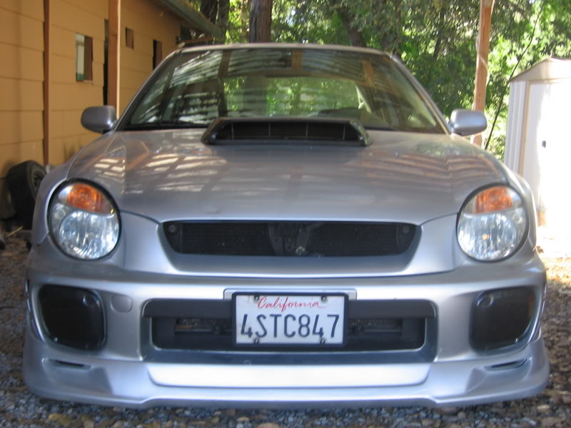

what is up guys I think it is about time that I start puting some pics of this thing up. I have had this wrx for about a year. when I got it it had quite a few mods on it. I thought that I was going to have a car that would be a good driver/toy. act clutch flywheel ssr comp. rims.....

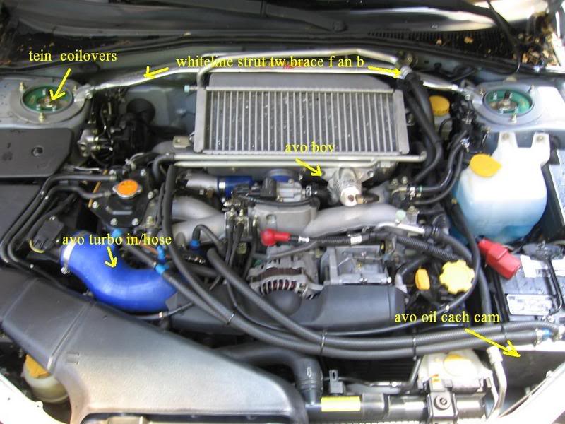

Mod list
Engine:
Sti 257
Pauter machine Billet rods (596 gm)
MAHLE coated pistons (391 gm) bore:100mm/3.937" stroke:79mm
balance and blueprinting by Frank @ Four star motorsports
rebuilt JDM V7 heads (8200 rpm capable)
all AVCS parts intact and working. with (06+ avcs silinoids)
stock wrx intake manifold with custom ported tgv housings (Rotated)
JDM V8 ECU with IA performance body harness wiring kit and modified wrx engine harness
Kakumei motorsports SS header
COBB uppipe

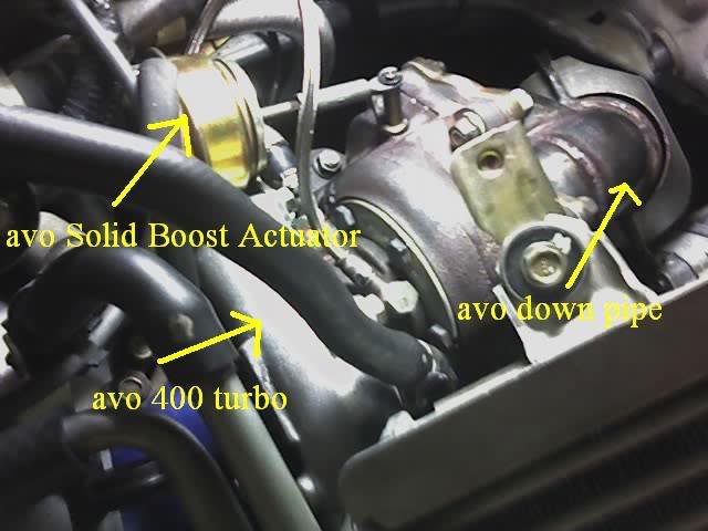

AVO 400 turbo
AVO downpipe (cated and Divorced Wastegate)
AVO polished SS catback
AVO turbo inlet hose
perrin shortram MAF (moved to intercooler pipeing
Greddy FMIC (customized intercooler piping)
