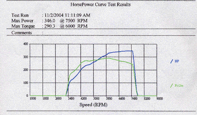

Here is a dyno sheet from about an hour ago, we are working on the mid range right now but to be honest don't want to go any further with pump gas as I don't see this car running too much of it anyway and it's all more geared towards 100 octane and C16.

nice preliminary numbers mike, I can't wait to see what its like when its putting down full power!
