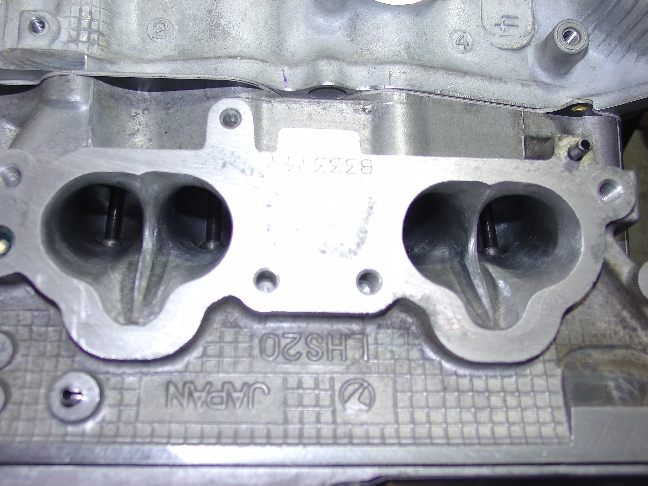

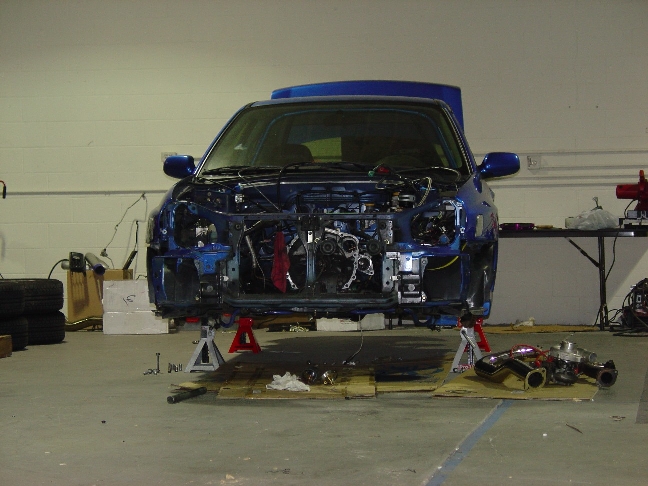

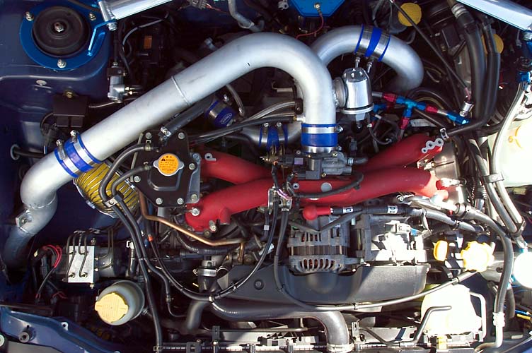

Well I have been working on my project 02 WRX for about 3 years now, The car used to fairly clean with our prototype GT30 turbo kit on a stock WRX engine. I since then had a slight overboost issue due to a 3rd party mechanic and some crappy work (34psi on pump gas). This resulted in the rings being blow and some very leaky valves.
The three pictures on this post are how it was.
Attached Thumbnails My Blue Bucket-mpj_performance_0001.jpg   My Blue Bucket-mpj_performance_0030.jpg   My Blue Bucket-mpj_performance_0037.jpg

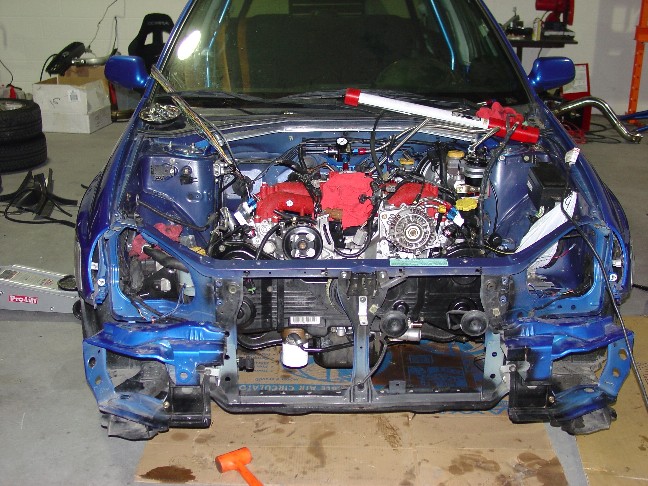

Ok well here it is about 10 minutes ago....

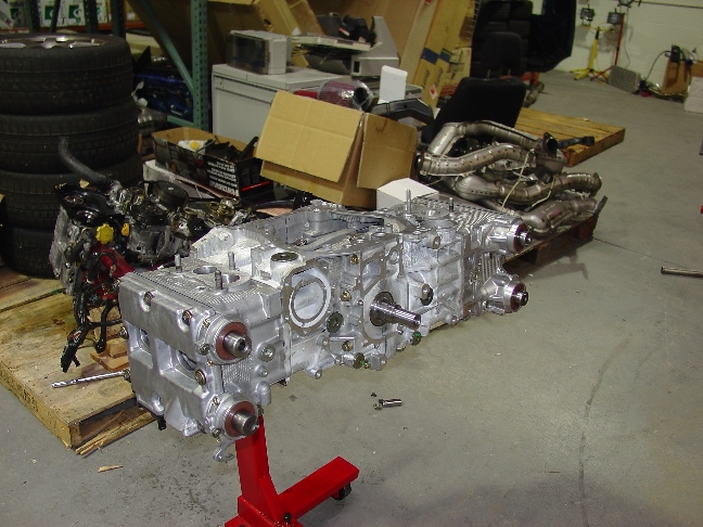

Ok so now you might ask "ok so the motor is toast so what is going into it then"

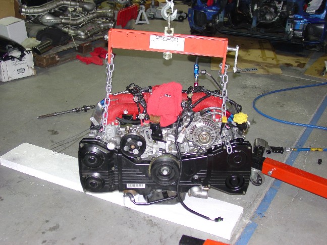

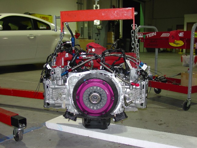

Well that was a problem, do we rebuild the stock motor for another round of abuse or put something a little more exotic in there. Here is what we found on the back of a Bax Global truck (ordered in December delivered twice, finally on a stand in August)
Attached Thumbnails My Blue Bucket-dsc00466_s.jpg   My Blue Bucket-dsc00470_s.jpg

Yea the engine finally showed up and by the looks of it unscathed.
Specs on the engine are as follows,
2.2L block
New Age USDM STI crank (not quite stock though)
Oliver rods
CP pistons
USDM heads (ported polished)
Axis racing stage 2 valvetrain and oversized valves
JUN 272 cams with slightly different spec's than the off the shelf versions
Technically the displacement is 2.33L with a compression of 9:1 and a capable redline of around 9k.
Turbowise I'm not sure at this stage, I think when the old GT30r gets back from it's inspection at Garrett I'll use that and see how it goes. I'm not looking for a drag setup just trying to make a broad usuable powerband, we'll see I guess.

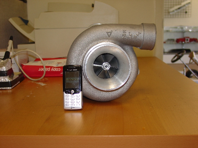

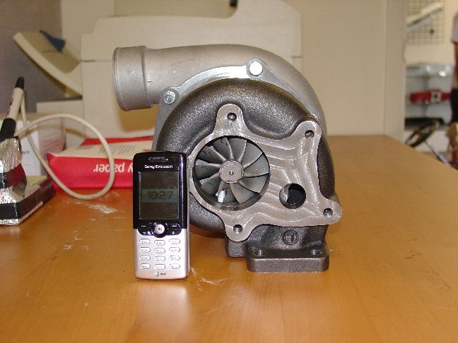

My turbo was sent out for inspection and now is lost somewhere at Garrett so we located a unit to try on initial fire up of the car..
