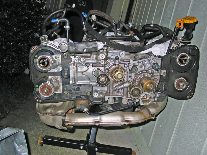

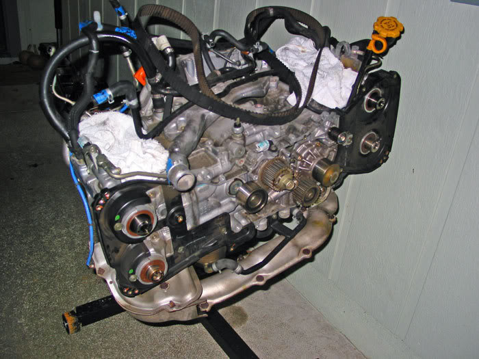

Worked on the motor some today. A suby homie stopped by and lended a hand. Thanks Nick.
Slowly but surely....
Got the timing belt and all the cam gears off. they are 10mm allen heads and the last one stripped of course. Had to dremel the round outer part of the bolt and make a it squared with 6 sides so I could get a Craftsman's #10 Bolt Out socket (hammered it the hell on) and it FINALLY came off!
