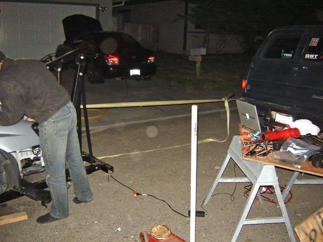

Now to get it on a stand and go to town.
<---pats self on back.
Thanks a million aboothman and my neighbor Damien!!!

why though what happened
Old Nov 9, 2007 | 11:20 AM
STiYLIN's Avatar
Posts: 3,160
From: Slumboldt

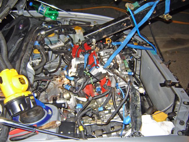

Ever since about 30k I have been getting air bubbles in my coolant. It happened very slowly and only when I was under boost for a long time or going up crazy mountains (boosting). I would have to burp my coolant every so often. WEll when I got the race gas tune it just made the air come in quicker. Suspected stretched head studs and a slight head gasket lift under boost.
So I got new ARP head studs, new HG, new water pump, gasket, and timing belt. If Mike calls me back I am going to get motor mounts (mine are blown) and get a new tranny mount.
New turbo is also going on and header is coming off for porting.
Maybe more once I see the cond of the internals there might be more added to the list
It was running very strong, minus the air bubbles and pushing coolant. Some I am hopeful.
Oh and go figure, my turbo has a big crack in it on the hotside all the way to the WG. Go finger

That must be one badass suburban with tein suspension

do you drive that suburban? or just use it to aid STi related projects haha, its in every pic doing something.
And it looks like your pulley is gonna break at any moment, like the 8 *TINY* points were it was billeted out are gonna snap!

I drive the Burban, especially right now . It is good to hook a come along to and pop the tranny lose from the motor.
As for the pulley, had it for 35k and it hasn't shattered yet. Time will tell!
