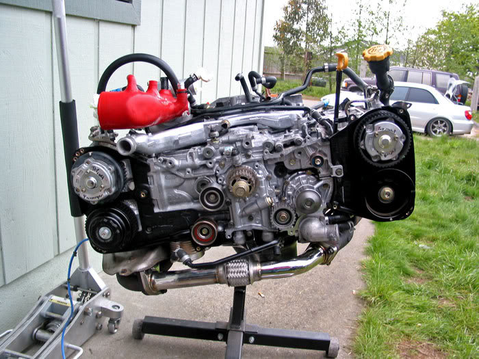

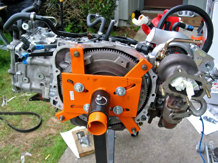

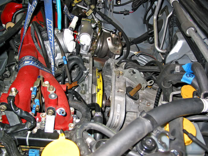

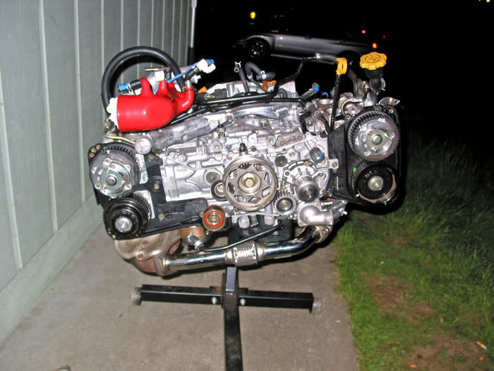

Here is what I got done today.
Hopefully the weather holds and it is sunny tomorrow and I can get a bunch more done. Hopefully it's ready to drop in the car by Saturday.

Put on the turbo, turbo inlet, Coilpacks, Exhaust Manifold, all 4 cam pulleys, misc pulleys, back of plastic belt cover, and some misc stuff. Pretty productive day. I am still taking my time though and being super careful and following the manual to a T.

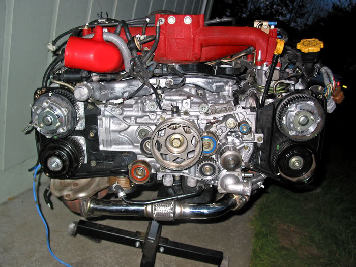

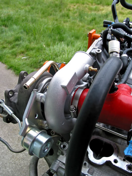

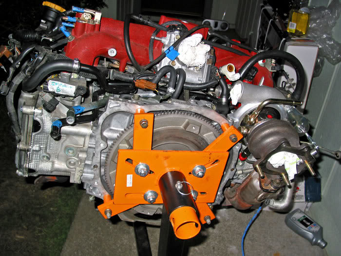

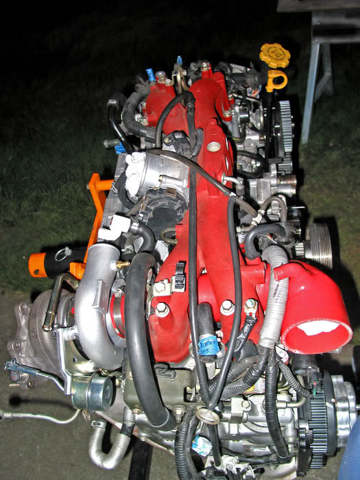

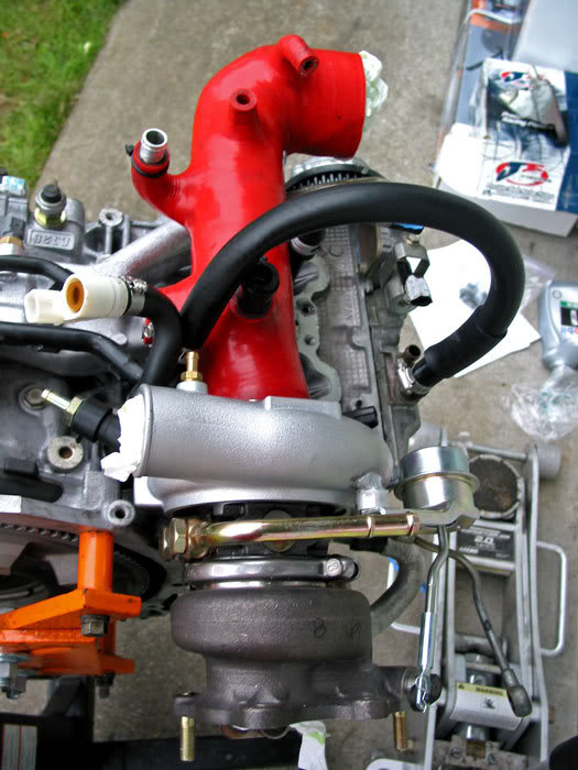

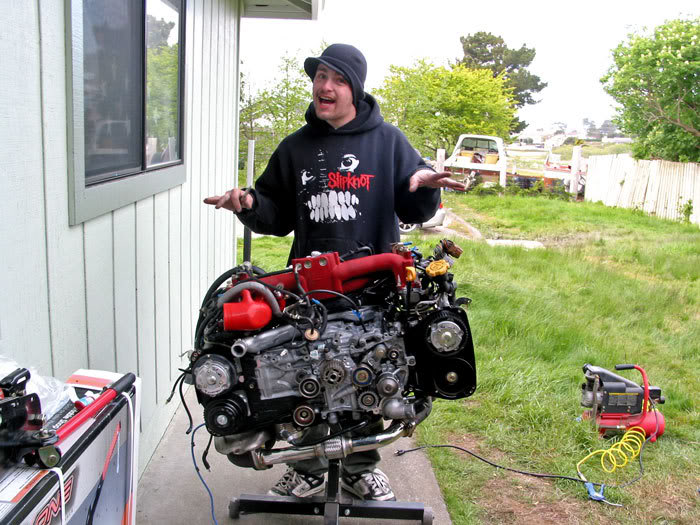

Another day. Seems like I keep taking 2 steps forward and one step back each day but it is moving along. Hopefully I can drop it in tomorrow or the next day. Getting close.
My neighbor posing for the camera AGAIN
So got the Intake Manifold installed. Had to really clean up all the connection points on the block and on the bottom of the IM as there was a little surface rust, gasket material, and some other crap.
Used 400 grit, then 600 grit, 1000, then 1500. Used new gaskets of course. I have done this to EVERY exhaust and metal to metal pieces that require a gasket. All new gaskets and in most cases new bolts. Made sure all the mating surfaces were as perfect as I could get them. Installed my 800cc injectors. Hooked up a bunch hoses and electrical connections.
Installed the belt tensioner and had to re-install the turbo inlet once the IM was one. Man that is a pain. Weather was crappy windy and cold today but I got out the thermals and the beanie and put in some work. I am so ready for this project to be over I can taste it!

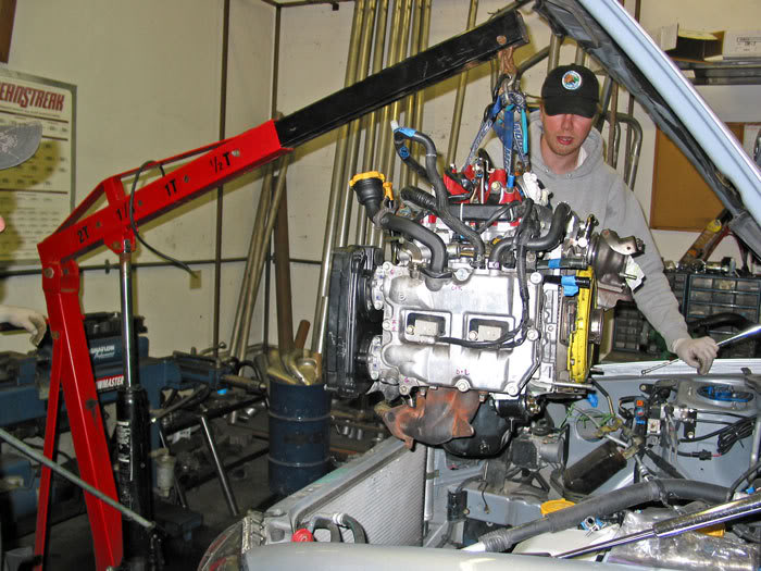

Called Matt, looks like he is gonna help a nugga out. He is calling you to get the trailer ready to come get my pos and bring it down to Fortuna so we can drop the motor in and time it. It is about 90% together as it sits on my porch right now. I am sure by the end of tomorrow we will have this beast running if all goes well.

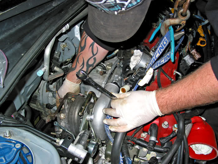

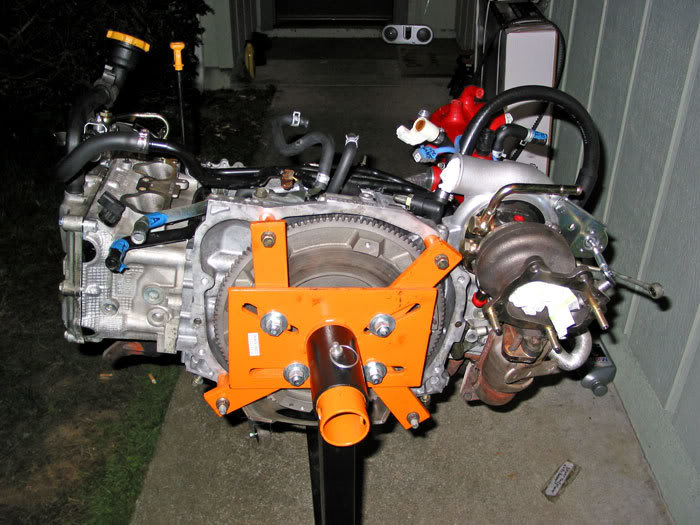

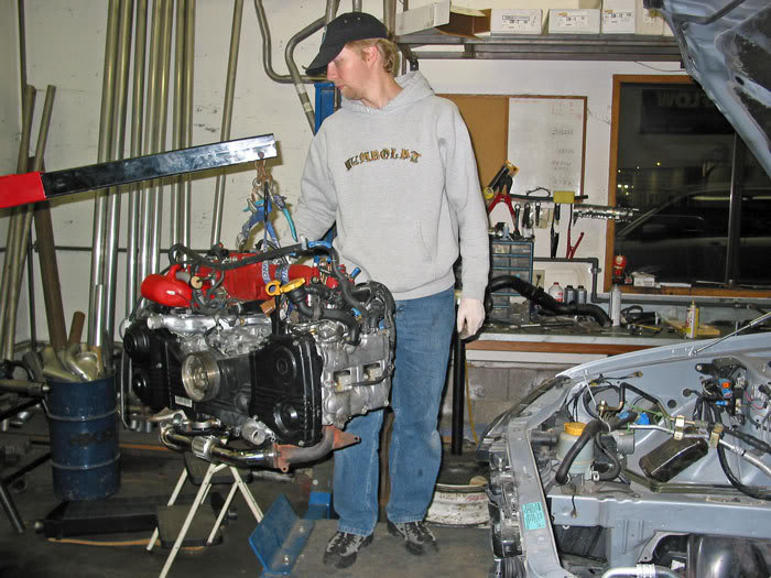

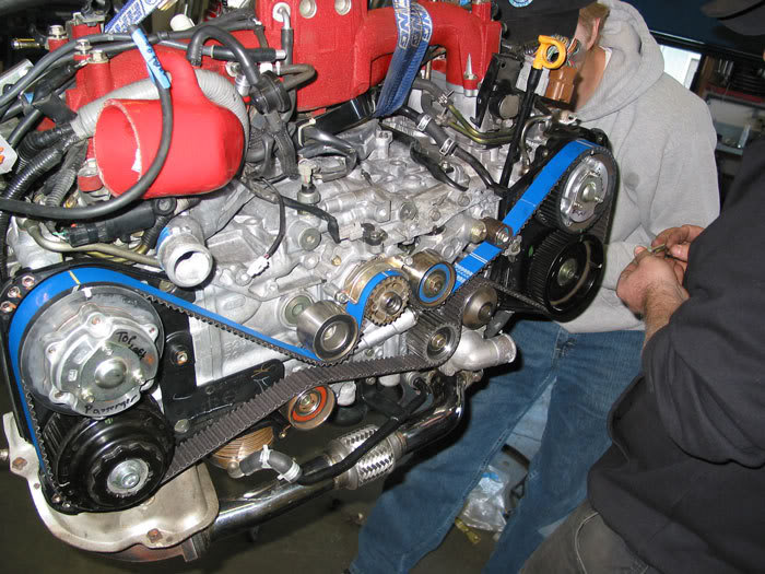

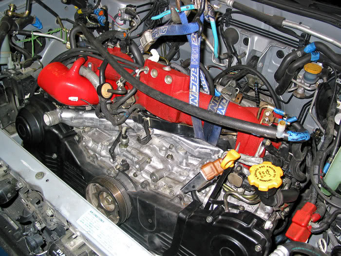

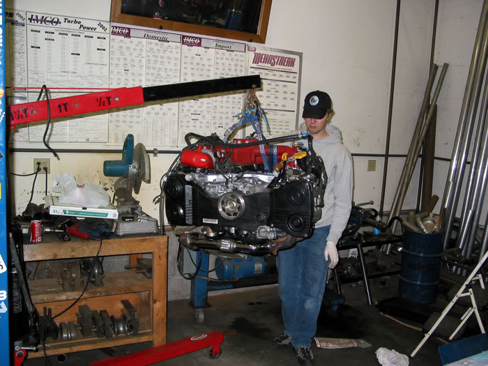

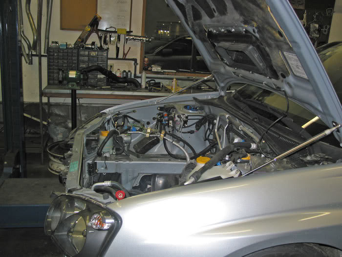

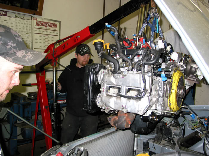

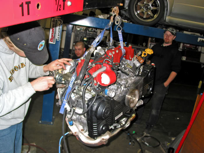

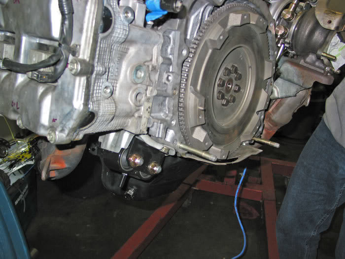

Well, should be starting it tomorrow. My tuner Mike is going to send me my break in map around noon and we are going to try to fire her up!
Old Apr 20, 2008 | 02:52 AM
  #179
Never Slip'N''s Avatar
Posts: 491
From: Humboldt County Cali
Car Info: '05 WRX STi
Old Apr 20, 2008 | 09:47 AM
  #180
turbosmurf02's Avatar
Joined: Jan 2007
Posts: 309
From: humboldt county, CA
Car Info: 2006 Evo IX SSL
WOW! So much craziness, im glad you finally have your motor back in its home base lol. Alot of time & effort, good luck on your future tuning, should be one powerful outcome.
