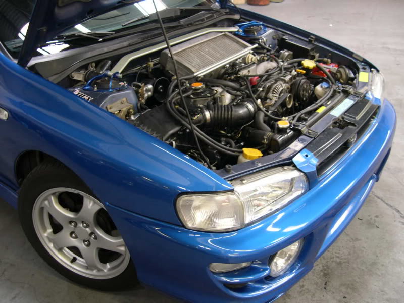

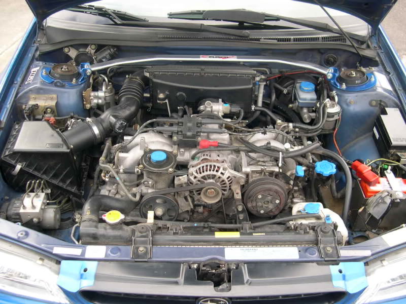

Some pics from they day I drove it down to the shop and one of the ol' EJ25. Notice in the 2nd pic no muffler, left it off on the way there.. boy was that LOUD!! Hahaha

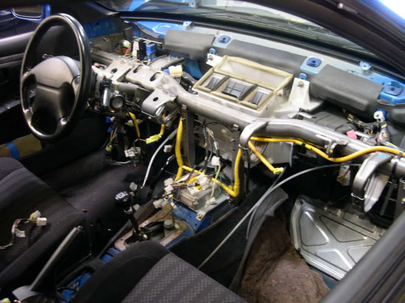

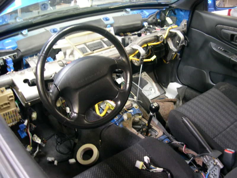

And a couple teasers from today...

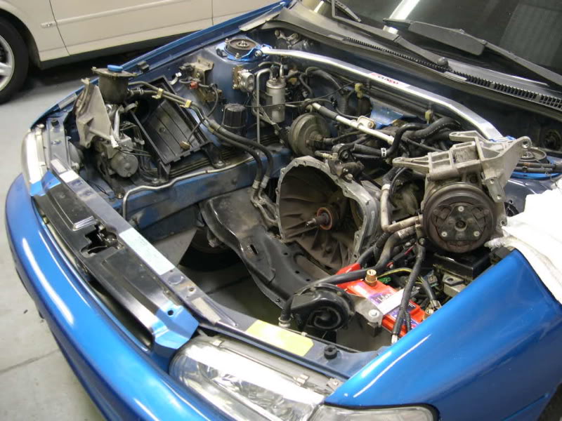

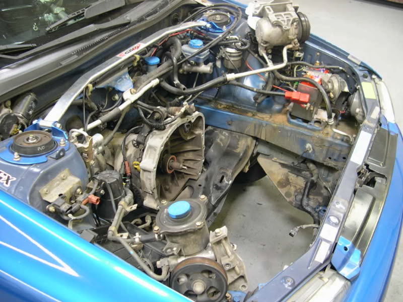

Alright the shop has been behind schedule so not much I can do about that. Went by there today and picked up my old EJ25 since a member on here is buying it from me. As of now you can see below car has no motor. Tomorrow the crossmember should be pulled and replaced with the new one and the EJ20 is planned to get dropped in.

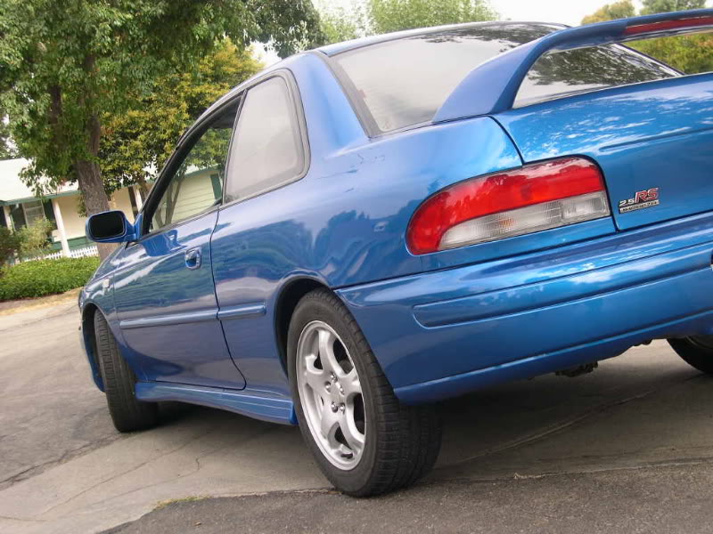

Talking Hey hey!!
Got my conversion back today, I'm soo stoked. Everything still works fine including my keyless entry, alarm and cruise control. One slight issue is the car is thowing a CEL for "automatic transmission failure" except I have a 5spd and got my 02 WRX ECU from a 5spd, so I don't even know why its doing that. Putting that aside, the car feels totally different and so much more powerful but I haven't gone past 4K on shifts yet. My clutch is still breaking in so it shudders going into 1st and reverse. It should be better though after it gets driven ~500 miles. So for now I'm just taking it easy. More pics to come this is just a quickie I took in the shop today.
