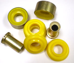

Whiteline Rear Differential Mount Inserts

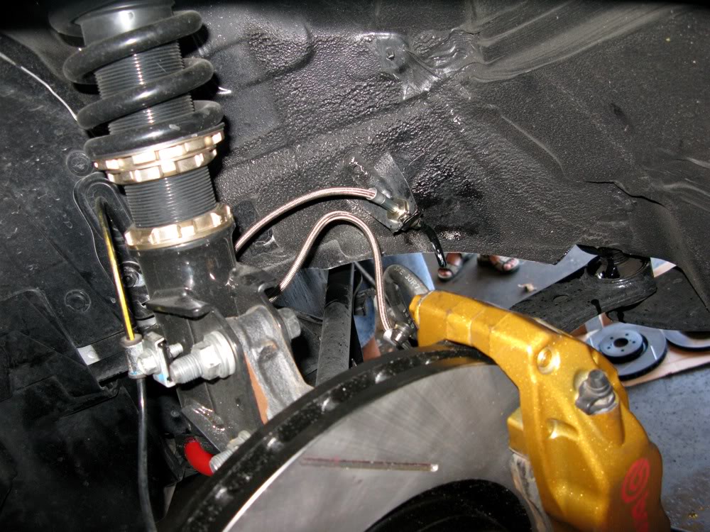

Front Brake Install:
I am pleased to report that installation of the front was very straight forward. 04 STI spec rotors bolted up with no issue. The Calipers bolted up with the proper bolts with no issue. The stainless lines were also a direct replacement. Even the splash shield stayed out of the way. Everything bolted up beautifully and boy did it look great!
Proper Bolts for Front and Rear Caliper to Knuckle Installation (103 for Front, 102 for Rear)

OEM Rubber Brake Line vs Goodridge G-Stop Stainless Line
Goodridge Stainless Line Installed

Rear Brake Install:
Here is where we, and most others, have had to get creative. First and foremost, I went ahead and lightly shot the rotors with an ultra high-temp black to get the hat and vents to match the front and to combat rust. Rotor fitment requires a few steps. The splash guard is completely in the way. Some suggest cutting reliefs and bending them back. Since we feel that defeats half the purpose, we decide to avoid a potential rattle situation and simply cut it out. We're in Southern California, where adverse weather is super rare, besides, we won't mind the additional cooling with the shield removed. Next, as seen in other threads, the inner lip on the back-side of the rotor needs to be shaved down about .150" to be properly seated on the hub. We took care of that rather easily, see picture below. At this point, we test fitted the rotors, which went on beautifully. We then slipped the caliper over the rotor and noticed that the knuckles were too far apart for the Brembo caliper to bolt on to! Uh oh.
At this point, we're exploring a couple of sources to find a proper adapter that will bolt onto the knuckles and provide two closer mounting points for the Brembo caliper. As cheezeball mentioned above, FastWRX.com does offer a solution for earlier WRXs, however they have yet to test it on the 3rd gen. We've gotten in touch with them and hope they will work with us to get this confirmed and tested soon!
A few pictures in the meantime. More will follow once we successfully mount the Rear Brakes on.
OEM rear rotor vs 04 STI spec rear rotor
Shaving Down the inner Lip that prevents proper seating to hub surface.
Removed Rear Splash Guard
Rear Hub Detail w/ Splash Guard Removed
Stay tuned.
