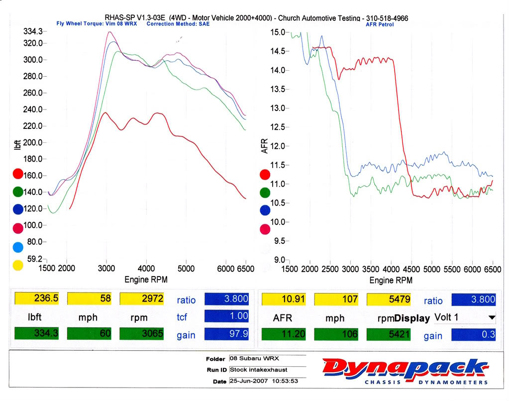

TORQUE AND HORSEPOWER - STAGE 2.52 vs STAGE 2.C1
TORQUE AND HORSEPOWER - STAGE 2.52 vs PRE-PROD
BOOST GRAPH - STAGE 2.52 vs STAGE 2.C1 - PEAK PSI
BOOST GRAPH - STAGE 2.52 vs STAGE 2.C1 - PSI @ 6500 RPM
AFR GRAPH - STAGE 2.52 vs PRE-PROD

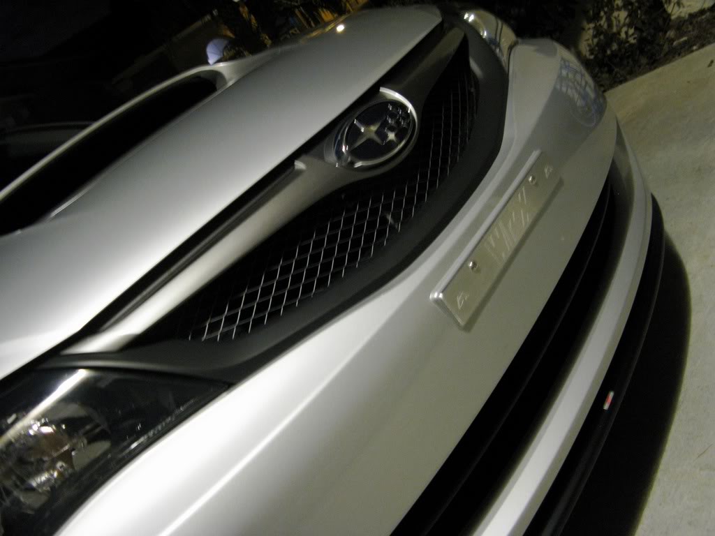

Alright, so these last 2 days have been a lot of fun with some of the detail mods I've added. These mods we're almost purely cosmetic, but I felt they were little details that could go a long way in providing the car with a more 'finished off' appearance. Mind you, the Perrin Shorty Antenna has not arrived yet, and neither has my COBB ****. So those changes are still pending...
So without further ado, I will post some pictures of the items installed along with a brief synopsis of my thoughts along with any notes I wanted to add.
SPT HEATSHIELD - The COBB unit did it's job I'm sure, but after a while it began to rattle. After tightening it down, the syndrome had apparently been cured, until one day... it again, reared its head. After another tightening, it refused to quite down. My best guess is that it was rattling against my wastegate actuator arm. Anyway, the SPT was more appealing to me as it has a little more stealth factor than the COBB. If you pop your hood for an officer, which do you think looks better? A heatshield that has the name COBB on it? Or would you rather it say SPT, which happens to match the tailpipes? Another thing that appealed to me was the thicker material of the SPT unit and it's mirrored finish. It's also nice that it has a 'do not touch with hand' picture. There is no actuator arm in the way with the new turbo, meaning the COBB may have worked just fine. But the other features of the SPT were great enough for me to swap over. Installation was very easy and everything fits and lines up perfectly. So yes, you can run the SPT Heatshield without the factory heatshield and with most likely any aftermarket DP. I love this piece.

STI FRONT LIP SPOILER - I enjoy the front end of the car, but like the rocker panels and rear, it just looked a little short and unfinished. Paging through Subaru's offerings, I came across this front lip and fell in love. Such a subtle piece. So expensive for the seeming amount of material you get. But I'd buy it all over again when considering the overall effect it has on the vehicle. Installation was fairly straight forward but involved. Drilling is absolutely required for most of the fasteners, and lifting the car a bit on a jack will aid a lot in the install. Overall though, fitment was incredibly precise, the piece was delivered in a huge box, but wrapped nicely in some synthetic protective cloth. It has a great satin black finish that coincidentally compliments my satin black vinyls, and I truly think it adds a real purpose-minded emphasis to the front end of the car.
STI Front Lip effect:
STI Front Lip and Splash Guards:

The stock clutch is officially gone. It had been shuddering for the last month upon any gentle activation in 1st gear, but performing flawlessly upon any aggressive launch, until recently. I first discovered the passing of the clutch on Thursday morning while cruising in 4th gear. I down-shifted to 3rd for a moderate sprint. The speed didn't really increase while the RPM simply shot up without any resistance. Immediately, I figured the clutch had simply overheated momentarily. So I let the car cool down and took it out again several hours later. Got to the highway, tried accelerating in 5th (high load) and sure enough, the clutch had quit at just shy of a young 12,000 miles.
While this may sound like a premature failure to some, there are some things that should be taken into consideration. First and foremost, this clutch has been withstanding a lofty peak 334 wtq for the last several months in comparison to the pre-production figure of 236 wtq. Remember this graph?
Across the entire rev band, that is a significant torque increase which will very obviously take a toll on a clutch designed for the more modest curve. The original clutch had also gotten me through at least 8 trips to the drag strip consisting of a minimum of 3 runs per trip. Finally, the oem clutch has a delayed release when instantly dumped at a high rpm. This cooks the clutch in the name of preventing that immediate shock from abusing the actual drive train. Smart move.
