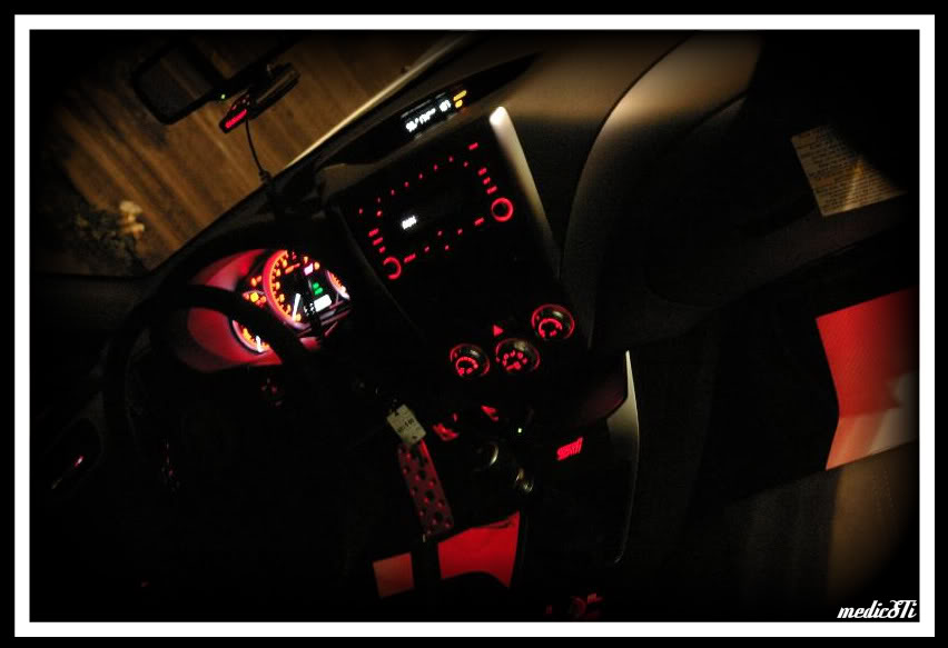

Yeah, I was in IMMENSE debate between blue or red, but went with blue because that little lower cubby light is blue, and all my upper dash is red. So I figured to keep it in theme. Upper dash -> red and lower dash -> blue
Got any pics of your foot well lighting? I'd be really curious to see the red, and I think it would go with the interior theme of the STI better anyway. How difficult was install?
lol yeah I noticed the shorty!!!
This is the only picture I have in my Photobucket that shows the red lights, it's the night I bought the car so it still had the paper matts
They're factory on the STi, STi FTW!!!
