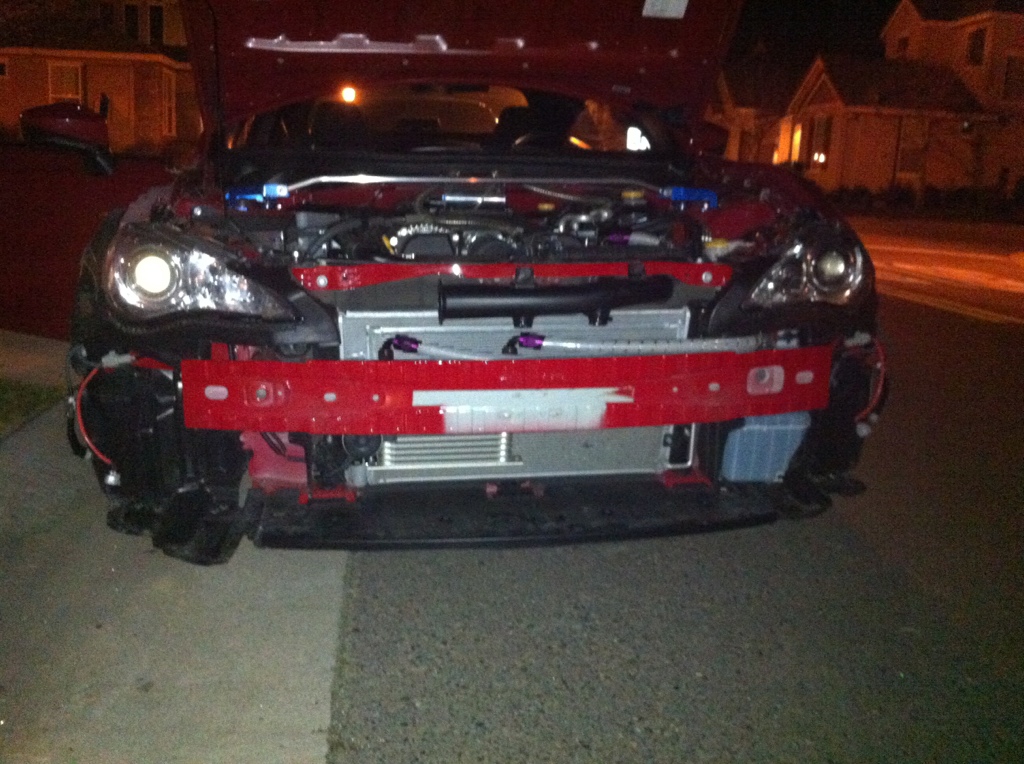

So my weekend project was installing the HKS oil cooler kit onto the 86 in preparation for my track day in early Feb. The kit didnt come with any mounts/brackets, to my surprise, so I had to fab up some. The instructions say to install it in front of the passenger wheel behind the fog light area.. Without custom mounts, that should have come with the kit, I found no way of this being possible. So I went to Home Depot and bought a few different types of brackets to try to get something to work. .. Decided to mount in from of the radiator and branched off the existing AC condenser brackets. Magically the brackets I got from HD sat at the perfect position to mount the cooler core. I was shocked. So I ground some metal and cut the brackets and walla! It sat perfect. Painted the mounts black to color match/rust protectant. Mounted it up, ran the hoses and all I have to do now is change the oil. I'm pretty happy with how it came out. Lmk what you think.
Kyle

So I changed the oil after work. Finally got to install this little guy

Fired her up and checked for leaks.. None .
Drove up and down the street and get it up to temp. Everything looks good
