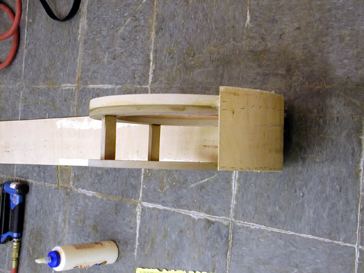

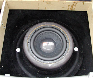

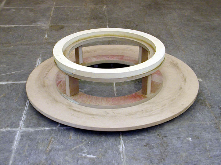

how did you make the subwoofer enclosure?

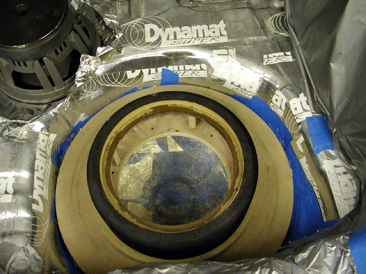

The sub enclosure design took me nearly two week to design and to fit properly.
First I used fiberglass and molded the lower portion of the spare tire well, this is about 2-3" deep.
Then I made a 24" round plate that sits on top of the mold and is the base that the wheel sits on.
Then there is a middle section that fits into the wheel. This was made with a couple pieces of 1/2" mdf and 1/8" bendable plywood. After the cylinder was formed I applied a layer of fiberglass for added strength and a couple layers of Dynamat tot he interior to deaden the interior of the enclosure.
Total airspace is about 0.75 cubic feet, which the JBL GTO 1220 woofer works very well in.
Here are a few more pictures.

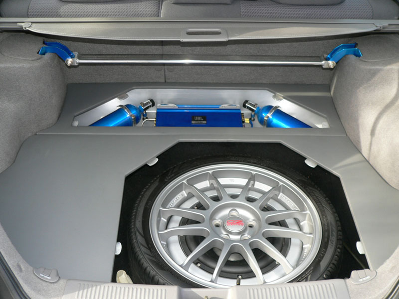

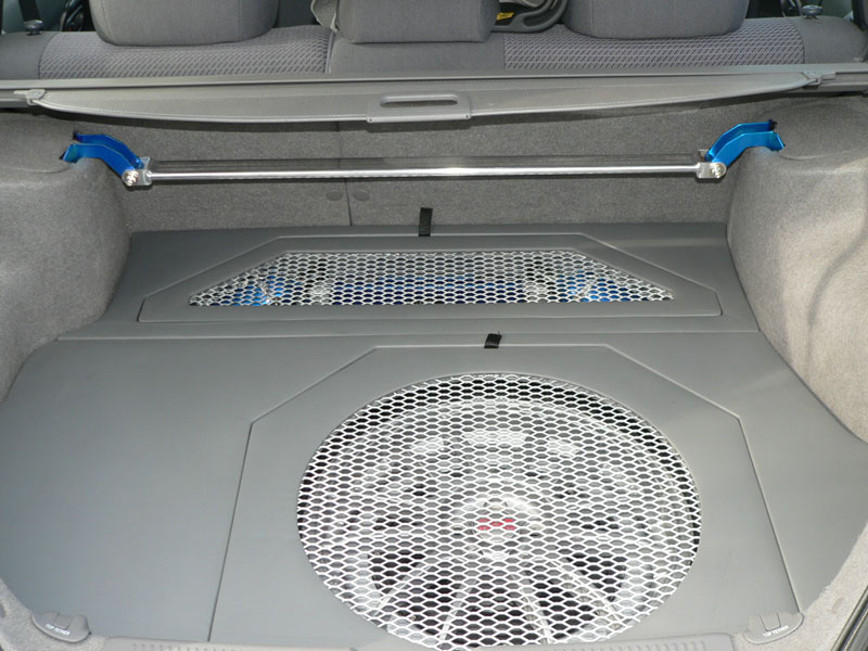

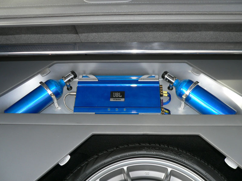

Finaly got my new camera
I finaly got my new camera and took some pictures of the finished install.
Here is the truck layout. The mesh is 1/2" expanded aluminum and this will be used in the front grilles and ram air that I am working on.
Also I am working on a rear wing - this is being modified from another car. I will provide pics and more info once I get this completed. Don't want to give up my secrets before I ready to show it off.
Anyway - here is the amp rack with NX 2.5lb bottles and all of the fiberglass painted to match the exterior.
Attached Thumbnails 2004 Impreza 2.5 wagon-amprack04.jpg   2004 Impreza 2.5 wagon-amprack05.jpg   2004 Impreza 2.5 wagon-amprack03.jpg
