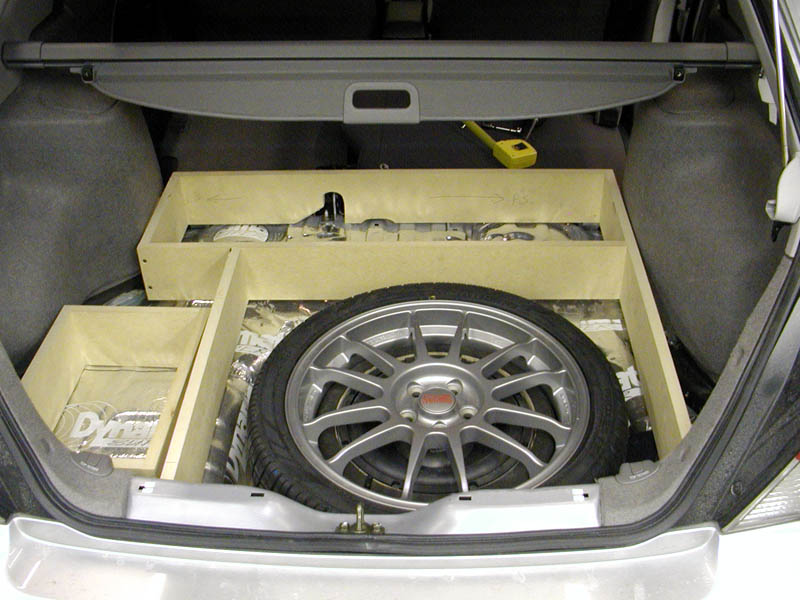

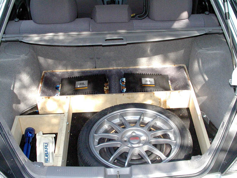

I am in the middle of building the amplifier and subwoofer enclosure now (pictures below). I wanted a very functional vehicle and wanted to keep as much space as possible. At this moment I have a JBL BP600.1 and a P80.4 amplifier installed in a fiberglass tube along the back seat. This is being replaced with a new rack that will house a JBL CS200.1 and two 2lbs NX bottles all powder coated in clear blue.
The sub enclosure is a single JBL GTO1220 12" subwoofer that was molded into a full sized 17" spare tire. Check out the pictures.

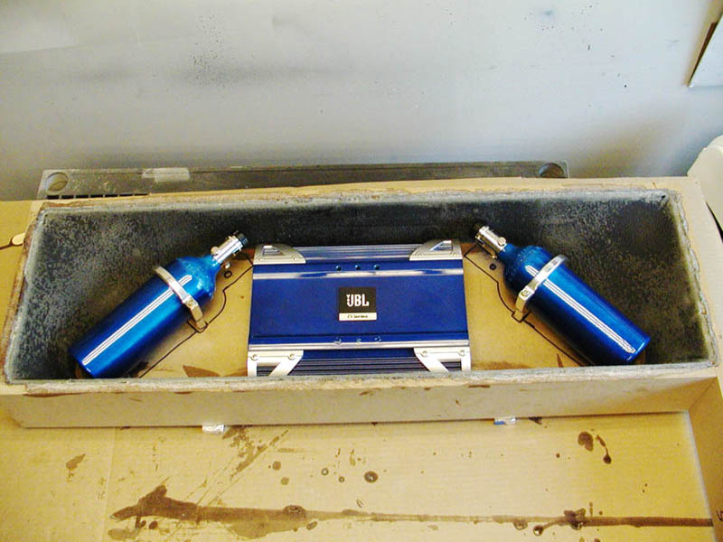

Amp rack update.
1. Here is a picture of the current install with two amps and a little pocket for the jack, tool and a Mag light.
2. Here is a picture of the new amp rack that I am in the middle of building with a single amp and the two NX bottles. Everthing is going to be powder coated in clear blue, so there will be slight color variations depending on the material being coated.
Along with this I have also made a custom battery bracket and fuse holder bracket to go under the hood. Once my Optima battery gets in I will update this with those pictures.

Install looks like it will be really nice, man. I really like the sub enclosure, having the OZ on top is a nice touch, and makes a pretty beefy grill

Car Info: 2004 Impreza 2.5TS
Thanks - its a beefy grill but is also a fully functional spare tire. The hard part was getting the spare to fit over the enlcosure due to the limited space around the wheel well.
I just have to pop off the edge trim peice to get the spare out.

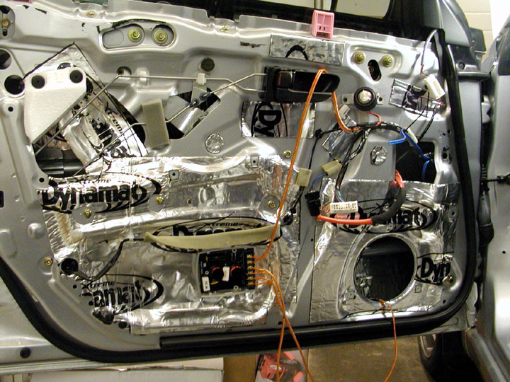

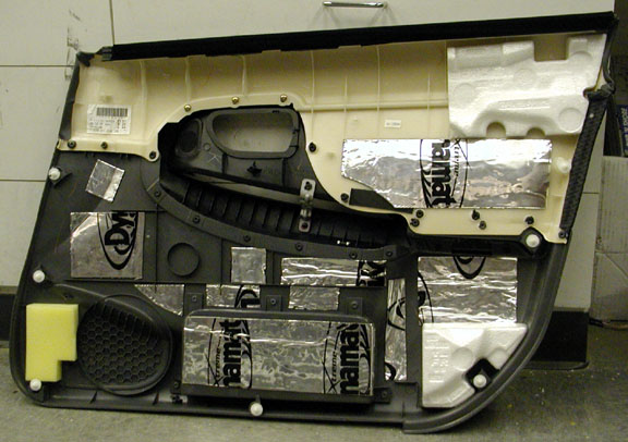

Here are the front doors being worked on.
I have installed a JBL P650c component system. This was a little tricky due to the VERY limited space in the front doors. My goal was to maintain the stock door panel appearance and not have to build custom grills.
First the door panel was removed and all of the plastic lining was removed. From there I added a layer of Dynamat Xtreme to all of the metal surfaces inside and out. This helps reduce road noise and vibrations, plus it helps improve the speaker's mid-bass response.

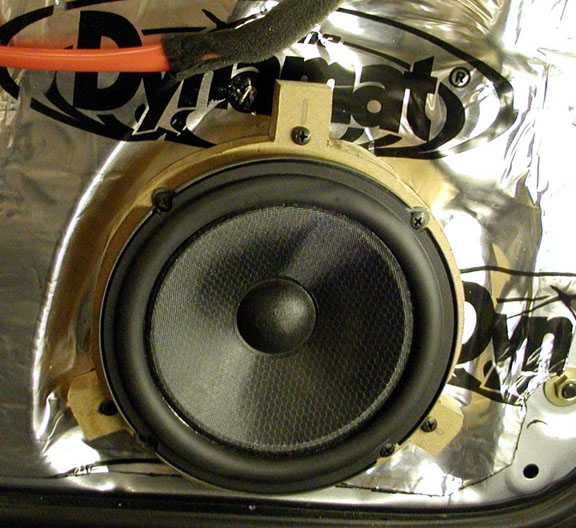

Next I have to make space rings for the 6.5" speakers and brackets for the tweeters. You can buy all of this off the internet but I have all of the parts around the shop.
The spacer is made from 3/4" MDF and is cut the match the factory speaker mounts. Then you have to sand down the plastic fins on the back of the door panel to get the best clearance, these can also leave marks (or break) in the speaker's surrounds and cones if you are not careful.
The tweeter bracket is a thing piece of 20 awg steel that was bent in a vice to achieve the proper angles for the tweeter to sit behind the factory opening.
I ran all new wires from the amplifier into the doors for the best performance. This takes a lot longer then just splicing into the factory speakers, but it is worth it.
The passive crossovers are tucked away in the door panel behind the map pocket.
If you need more specific just send let me know.

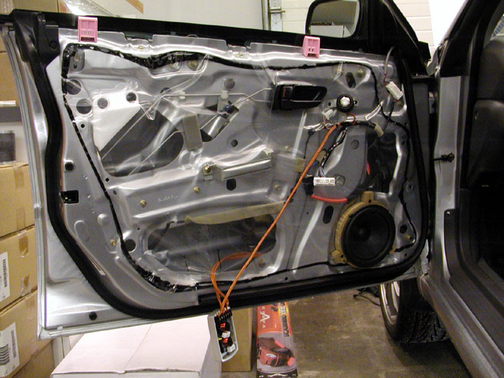

Photos of the front doors. Before and after Dynamat.
Results - much quieter ride. There is very little noise control materials in the Impreza's and WRX's. This adds some additional weight but the ride down the highway is much quieter.

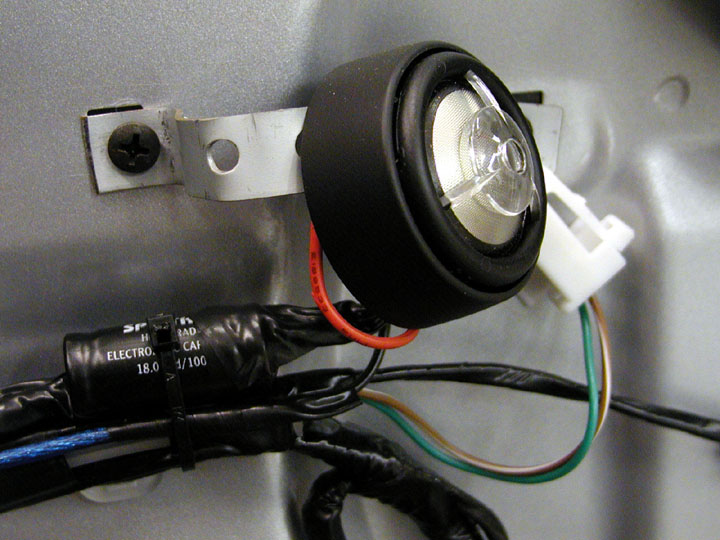

Here are some pictures of the speakers being installed in the front doors.
I used a JBL P650c 6.5" component system for the main speakers.
The 6.5" mid bass required a little time to install properly. A 3/4" spacer ring was made from MDF wood using one of the adaptor rings that came with the speaker as the templet. Also there are several plastic fins on the inside of the panel that need to ground down with a Dremmel tool.
As for the tweeter mount, you can buy the factory tweeters and remove the mounts or make you own out of some radio back-strap like I did. Just use a vice and pliers.
The crossover network was mounted with double sided tape and fits into the door panel behind the map pocket. See the door panel picture above.
