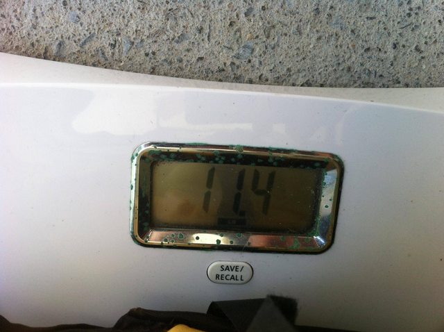

Pieces removed:
Rear Small Seatback:
Rear Large Seatback:
Rear Bottom Seat:
Replacement Pieces:
New Front Seat(One seat weight, not including brackets/sliders):

I didn't, but I will add the total of everything I take out and will be relatively close.
