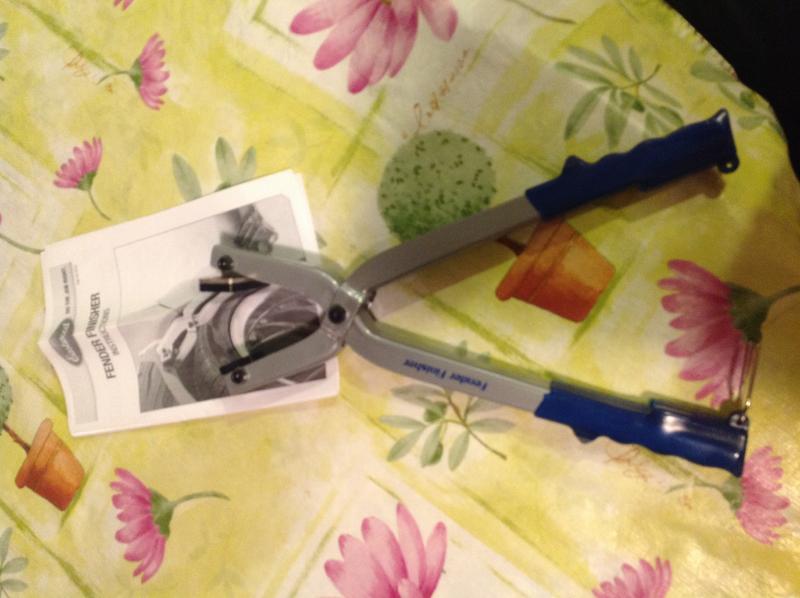

Sigterm- fender finisher.
Attached Thumbnails Project Weightloss: SM 02 WRX Wagon-image.jpg
Can I just lilve in your garage or something? I will keep it clean, all I need is a cot in the corner.
Can't even fit a cot? You would have to sleep in the WRX. Lol.
LOL! yea, not too much space in there that's for sure.
As for the Fender finisher, I looked it up, watched a vid, interesting to say the least! Might need to get in your good graces to help me finish my fronts up over the next month or so.
