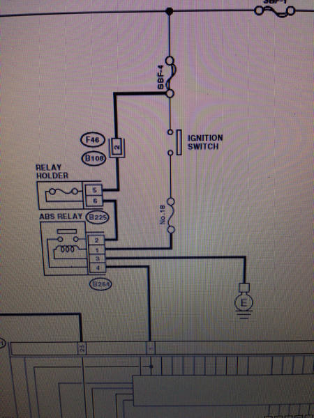

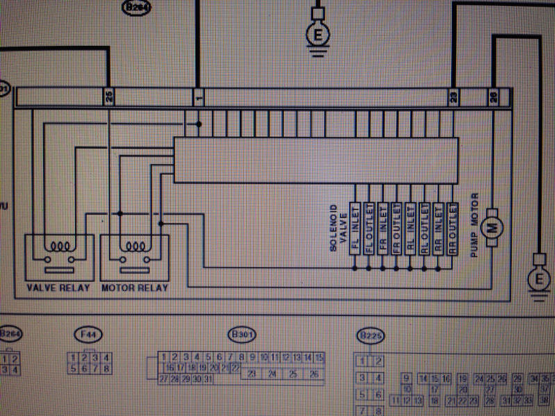

Well from all the wire diagrams I am looking at it appears its the only thing left. I don't like the fact that apparently
The relay is within the pump and the pump is "unserviceable". I did find a crack on the plastic cover which is probably where water gets in, making the light go off.
Pin 25 takes power from battery(off screen) then goes to motor relay and onto the pump. Pin 1 comes from the ABS relay which clicks on with ignition thus activating the motor relay then pump. I tested this relay and it click when its supposed to. So I assume that the motor relay is STUCK closed then taking power from pin 25 and applying to Pump Motor.
LMK if i am reading this wrong
My code
DTC 52
ABNORMAL MOTOR AND/OR MOTOR RELAY
Attached Thumbnails ABS Problems-image-3915053217.jpg   ABS Problems-image-3545749216.jpg
