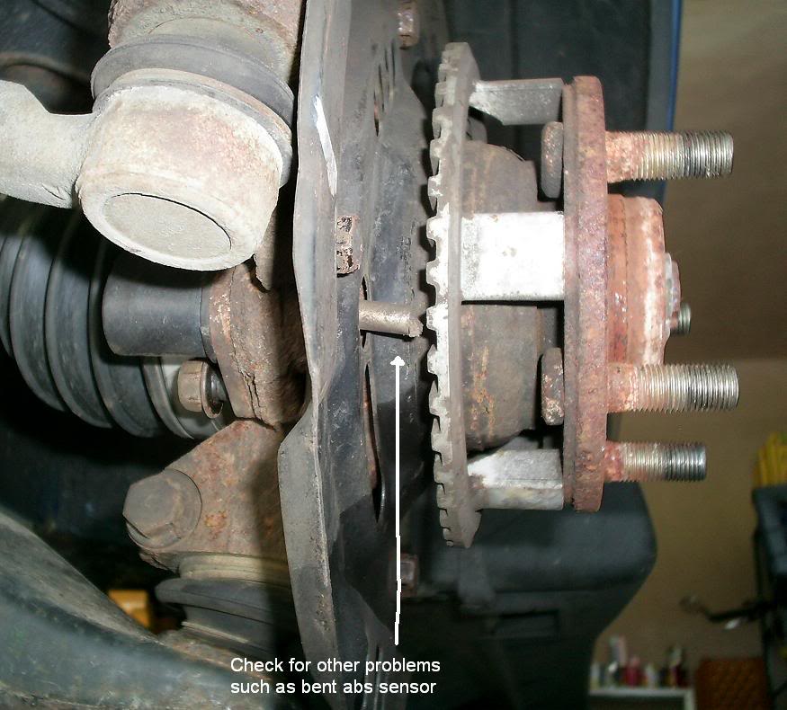

Here is a picture of the older style but the newer style is the same concept. Tone wheel has one tooth on it that is magnetic. The abs sensor is also magnetic.
Sometimes metal debris can get attracted to the sensor and cause the reading to be off.
I would go over to the side of the car where you hit the water puddles and inspect the sensor in the front and back of the car on that side.

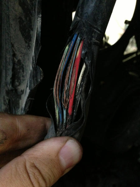

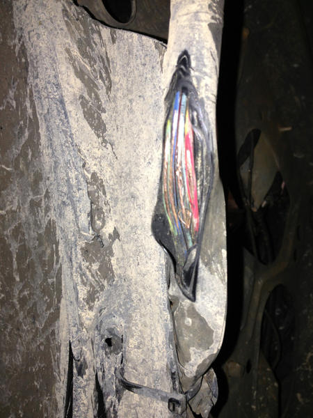

Nom nom nom. Found my problem . I need to get my soldering skills up.
At least I hope that's the only prob
Any suggestions?
