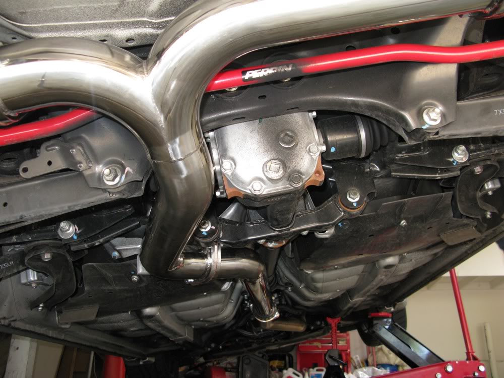

As promised, here are some pictures during the install, compared to the SPT.
True 3" Internal Diameter and a stress reducing flex bend at the downpipe mating flange.
TurboXS's stunning mirror polished finished. Should match their Front Mount Piping well
The TurboXS has less bends and appears more progressive in flow.
Smooth flowing Y-Section!
Diameter difference.
Mounted up. Y-Section.
Mounted up. Driver's Side Muffler.
