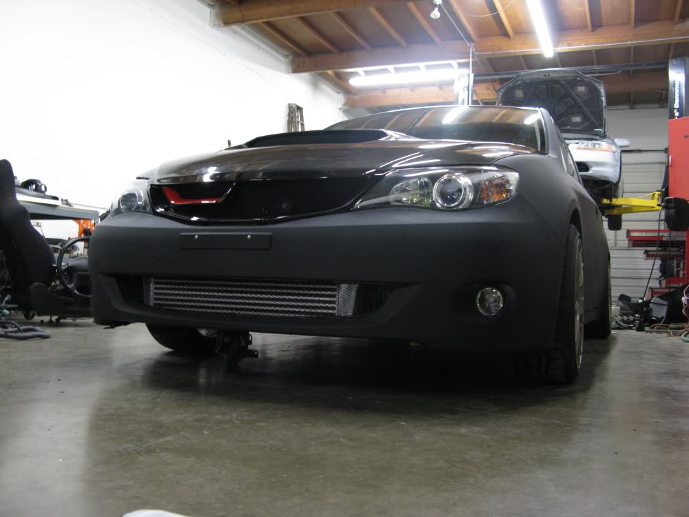

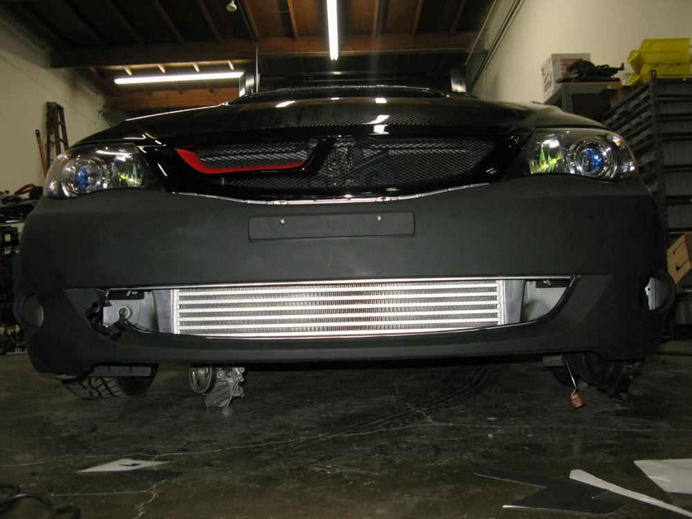

Worked on the car a bit tonight.
Finished up some of the vinyling on the front bumper, went ahead and did the front plate delete as well. Re-installed the foglights, drilled out some little holes for zip-typing the mesh I made onto the lower grille.
Before the grille and foglamps:
Drilled little holes:
Ready for the grille:
Yay!:
Front Bumper Detail:
We're so close to completion, I cannot wait.
