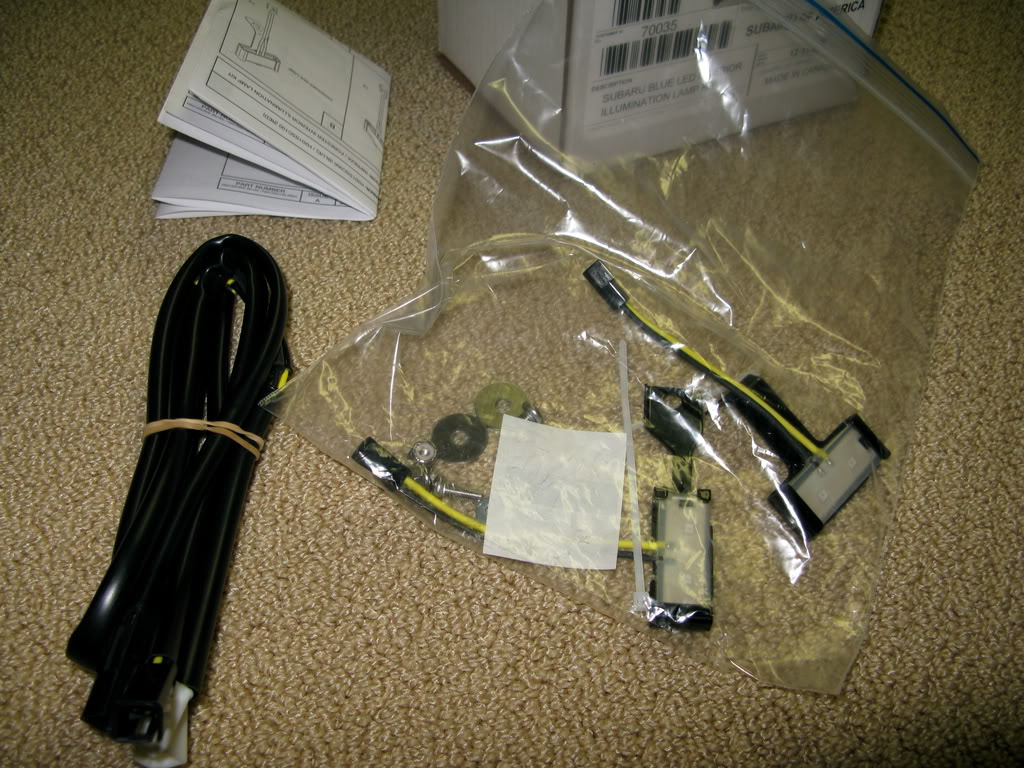

----ITEMS I'LL BE INSTALLING TOMORROW----
SPT HEATSHIELD:
SUBARU SPLASH GUARDS - EXTERIOR COLOR MATCHED (SPARK SILVER METALLIC):
SUBARU FOOTWELL ILLUMINATION KIT - BLUE:
SUBARU STI SPOILER FOR WRX:
SPT HEATSHIELD:
