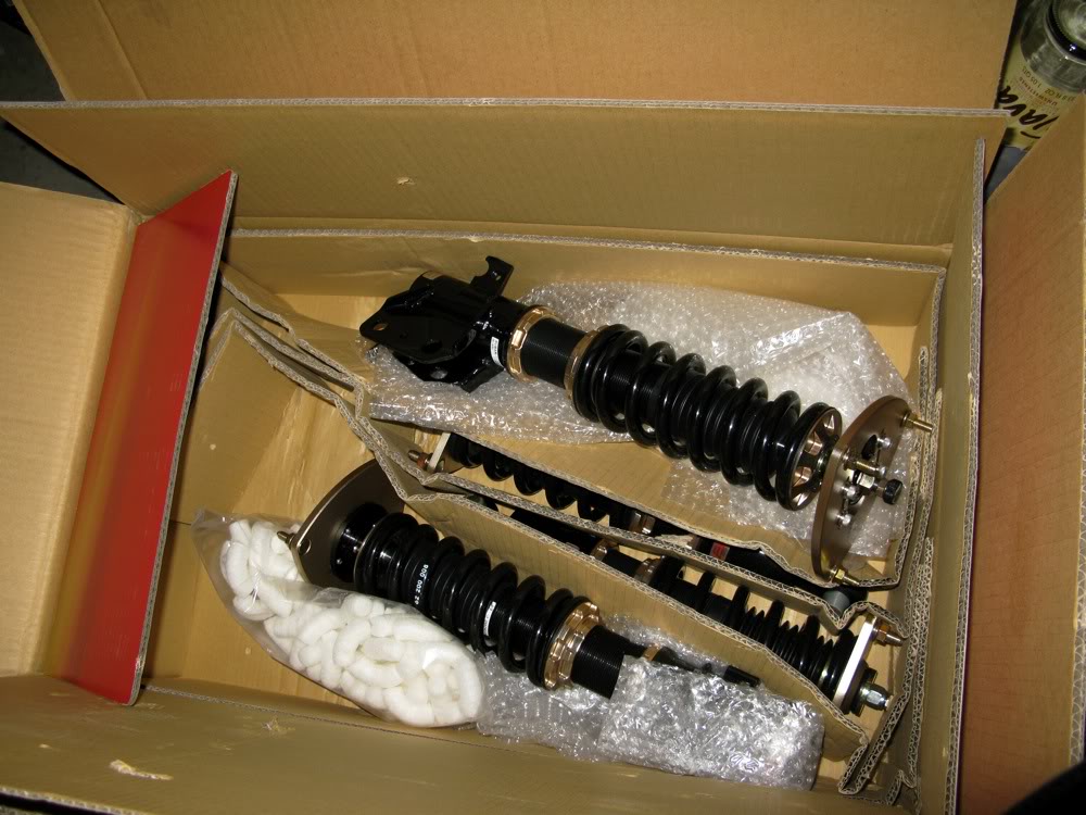

Update 05.20.2009
My research for Coilovers is complete. After a lot of reading, discussion and thought, I've ordered a set of BC Coilovers and selected a custom set of spring rates. In the meantime, I also set up a retail relationship with BC, so Treble Racing will be carrying BC Coilovers very soon for anyone interested.
Some Facts:
HOW TO PROMOTE UNDERSTEER - Heavier spring rates in FR, Softer spring rates in RR, Higher tire pressures in FR, Lower tire pressures in RR, Positive camber in FR, Negative Camber in RR, Stiffer sway bar in FR, Softer sway bar in RR.
HOW TO PROMOTE OVERSTEER - Lighter spring rates in FR, Heavier spring rates in RR, Lower tire pressures in FR, Higher tire pressures in RR, Negative camber in FR, Positive camber in RR, Softer sway bar in FR, Stiffer sway bar in RR.
A Little Background:
The vehicle drives off the lot with an abundance of UNDERSTEER. It's got the right formula for it, after all (Positive FR camber, Negative RR camber, Heavier FR spring rates, Lighter RR spring rates, 20 mm FR sway bar, 15 mm RR sway bar). When we added the STI springs, we didn't know the spring rates. We only read that it promised an overall stiffness over stock. Good enough to try, we though... So we ran the set and felt they were a pretty significant improvement over stock with both response and reduction in body roll. Mind you, we were still on the stock wheels and tires. Then came the proverbial wrench...
We bought an 8-inch wide wheel and employed a stiff-walled, 180 Treadwear Kumho XS rubber in a fat 235 width to stick to the road better. The result in grip was enormous! However, the overall impact on the vehicles handling dynamics was negative! By reducing the amount of give a tire has against the road, the force is then absorbed more so by the springs and struts. Suddenly, it was Understeer City all over again, and the dynamics felt significantly worse than stock. The stiff tires coupled with a soft set of OEM struts made the highway ride suffer in terms of stability. Over average bumps, the vehicle would bob and bounce... Unacceptable!
What's Out There?
We wanted to purchase a set of coilovers for the project car that we can also sell to the public. This allows us to give people drives, and provides us a very real experience that we can communicate over to our customers. I looked into design, features, durability and warranty. I will not directly compare each set that we have access to, but for the sake of comparing spring rates, I will mention what's significant.
Suspension Package:
FR: Spring Rate
RR: Spring Rate
Subaru OEM 2008 WRX:
FR: 2.7 kgf/mm (151 lbs/in)
RR: 2.4 kgf/mm (137 lbs/in)
Subaru OEM 2009 WRX:
FR: 3.9 kgf/mm (217 lbs/in)
RR: 3.5 kgf/mm (194 lbs/in)
BC Racing BR:
FR: 6 kgf/mm (334 lbs/in)
RR: 8 kgf/mm (445 lbs/in)
BC Racing BR (Custom Rates for Boost Addict/Treble Racing):
FR: 8 kgf/mm (445 lbs/in)
Cusco:
FR: 7 kgf/mm (390 lbs/in)
RR: 5 kgf/mm (278 lbs/in)
Megan Racing Street:
Tein Basic:
Tein SS-P:
HKS Hipermax III:
RR: 6 kgf/mm (334 lbs/in)
What Did I Select?
BC Racing gave me the option to select whatever spring rate I wanted. If I exceeded the supplied rate by more than 2 kgf/mm, they would re-valve the dampers to match. I remained within spec by raising the FR rate by only 2 kgf/mm. Considering that I have plans to dial in some Negative Camber in the front and add a larger rear sway bar down the line(both of which promote oversteer), I felt that the supplied 6k/8k pairing may be slightly too aggressive in the rear. And since the '09 WRX already is supplied with 3.9k FR spring rates, I felt that I'd rather raise the FR spring rate, rather than drop the RR rate.
What Do I Hope To Achieve?
I expect the Coilovers to be on my car within the next 2 weeks. My Kumho's are wearing fast and I'm planning on my next set of tires will be Falken Azenis RT-615s in a wider tread and smaller overall diameter(245/40/17 vs the current 235/45/17). Considering the fairly heavy rates I've selected, I imagine the tires should start getting a bit of a workout in the corners. I will play with the compression/rebound rates and report my findings back.
My overall goal is to achieve a very firm and solid highway ride(at the willing sacrifice of some comfort). I want the car to feel planted during cornering with minimal body roll. I am also expecting corner rotation to improve significantly while still remaining slightly on the safe side with a touch of understeer at the limit. Expect a complete review.

What Did I Select?

Folks,
With regards to my impressions about the new coilovers, I'll leave you with a few questions.
Want your 4-door sedan to feel as firm, planted and composed as the likes of a 911? Would you like an independently adjustable ride height that does not compromise your spring travel or pre-load? Care to reduce your body roll to almost nothing?
I have a lot to share about the BCs, but I owe it to myself and everyone else to spend some more miles behind the wheel before i can review them in full.
