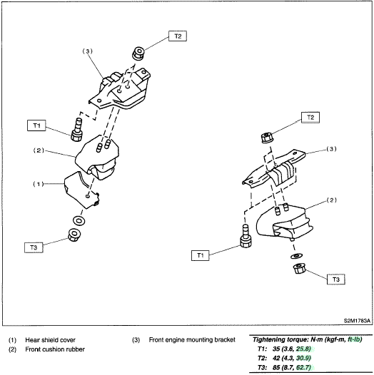

I am looking for the how much Torque to put on to the front engine mounts. I can't find it and I am not sure how much to torque them. Any help would be great. I am installing the new COBB up-pie right now and I had to take the nut off of the passenger side engine mount to get the old up-pipe out.

Origami posted by spectra
Torque in ft lbs is highlighted (other numbers are expressed as metric equivalents).
0==WW==0
