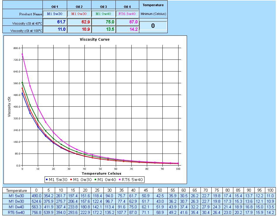

Just as a warning, RT6 may be a little thick for your application. Notice most, if not all, who are recommending RT6 have a turbo. The main reason why people avoid M1 is due to it shearing down to too thin of an oil because of the heat from the turbo. The two main oils Subaru WRX owners use, RT6 and GC, is because they're thicker and are more resistant to shearing to too thin of an oil.
Don't get me wrong, I use RT6 in my WRX, but again it's a turbo application.
Just my .02
Wouldn't it be thicker only if i used something with a higher viscosity like 5w-40? Or Is the oil in general just thicker?
And i only lost a quart of oil in about 3500 miles, so i probably don't need a thicker oil
RT6 is a 5w-40 oil. And comparing oil viscosity between companies is about as useful as comparing tire sizes between companies. A 0w-30 German Castrol vs a 0w-30 Mobil 1 is a night and day difference. The GC is much closer to a 40 weight and the M1 is closer to a 20 weight, which is why people tend to avoid M1 and go with GC in Subarus. Heck, even M1 5w-30 is thinner than M1 0w-30.
We're in California, you want to run something thicker anyways.
By your logic, if I moved to an even hotter place, should I be running a 5w-50? You make it sound like it's constantly over 100 degrees in CA, and even then, it doesn't make a significant difference as the motor is producing most of the heat in the oil.
Look at these past weeks, it's hit around 30 if not lower in many areas in NorCal and SoCal. Engine wear is normally the worst on a cold start up because oil needs to heat up to be at operating temps and viscosity. Hence you don't want to run a thicker oil than needed in the car.
