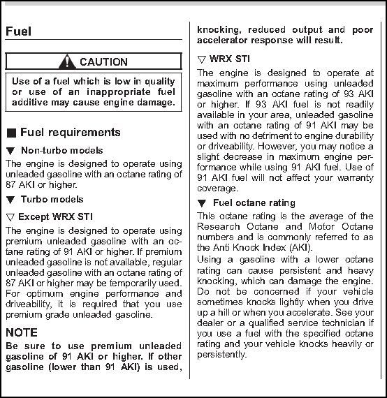

From the 09' Manual:
Almaden 76: Almaden/Foxworthy, San Jose
Woodside 76: 101 S, L Woodside, couple miles on your left
Sunoco 100 Octane - $6.299/gal San Jose, 6.599/gal Woodside
Here is the mix I use to make 91+ Octane for 14 gallons.
14 gal - 3.0 gal = 11 gal
11 gal * 91 oct = 1001
3.0 gal * 100 oct = 300
(1001 + 300) / 14 gal = 92.9 octane
