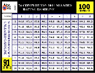

Thumbs up Found charts for mixing gas......
http://www.ls1info.com/print.php?sid=240
http://ls1info.com/420.09b.pdf <---- 92 & 100 octane chart!
This is a chart for mixing 91 oct gas and 100 oct race gas.

I read all of the information... Thank by the way.. but I don't quite understand what the chart is trying to say. If youre going to use 100 octane wouldn't you use it pure?
I think I know what the chart means but I'm not sure. If I mix 10 gallons of 100 to 1 gallon of 92 I get 99.3 Octane... that goes back to my last question... wouldn't you want to run it pure?
Or is this just incase you need to add octane since your gas tank is low you'll know what octane your running?

It's so you can make whatever octane you want to run in your car. You really don't need to run 100 pure, that's a waste of $$$. I want to run around 94.5 to 95 at the track just to be safe. This chart will let me do that.
