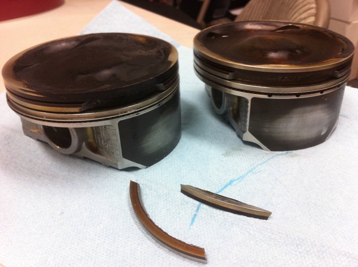

Originally Posted by EQ Tuning
You haven't heard of the ringland issue?? Its been a common well known weakness in all of the turbo 2.5l motors, but got significantly worse in the second half of 06. 07's used to pop bone stock and 08's were not much better.
The problem is in the inconsistency of the piston castings. Some of them have impurities which cause a major weakness at the thinest part of the piston (the ringland). Combine that weakness with a bit of knock from bad gas and/or a poor factory tune and you start developing small cracks through the ringlands. The first symptoms are oil consumption and eventually the ringland cracks further and causes missfires in some cases. They're completely hit or miss... some motors run great with lots of abuse and others break pistons bone stock within the first 15k miles.
-- Ed
Here are pictures of the awesomeness. These are out of cylinders 1 and 4. 41,000 miles on the car. Was running E85 for about 2 months and then noticed it was having issues. Prior to that just a super mellow stage 2 tune.
They have probably had cracks for a while, but the added stress of the power from the E85 tune is most likley what made them go.
How many miles and what kind of power output?
BTW, those pistons have not been cracked for very long.
